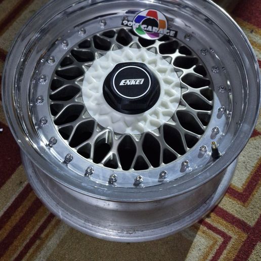

enkei EK98’s!! (i believe)This is such a great build!
WAIT HOL UP WHAT ARE THOSE WHEELS
@webby you have any leads on how one could go about finding/creating centre caps for older wheels? ive not found anything online or on marketplace.enkei EK98’s!! (i believe)
got the setup for $850 altogether from a guy who’s dad had hoarded them in a barn for 15+ years haha
still no luck finding center caps tho
I've seen people doing 3d print files of them if you're open to that. Otherwise, it's probably just the luck of the draw finding some on ebay or something.@webby you have any leads on how one could go about finding/creating centre caps for older wheels? ive not found anything online or on marketplace.
I’ve been seeing your posts on this forum since i started this build and you really seem to know all this niche info
				those ones from cults 3d look like they’d be a perfect fit actually!! I actually ordered and tried those Amazon ones but they were too small a diameter. Got the refund tho.I've seen people doing 3d print files of them if you're open to that. Otherwise, it's probably just the luck of the draw finding some on ebay or something.
