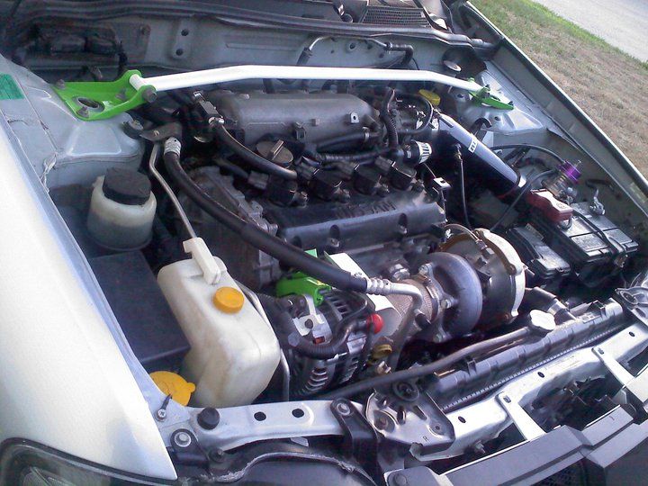

Since this is my toy and it gets most of the mods, here is a little glance at it.
Car makes about 300whp
Mods-Cutom turbo kit:
Precision 5557 Billet series turbo .63ar 73 trim turbine wheel, .60 ar compressor
Tial 38mm WG
Turbo XS RFL BOV
Custom IC piping and IC setup
WRX 440cc Injectors
Walbro 255 stock returnless system
Protech full 3inch mani, downpipe, and midpipe setup
VRS 3inch catback, no res, with Vibrant 3inch dual tip flat black muffler
Custom Catch Can
Custom steering wheel wideband pod
Custom a- pillar boost pod
Custom radio delete upper panel Oil psi gauge pod.
All pods, fiberglassed by ME
SAFC2, Innovate LC-1 XD-16 Kit with SSI-4
Autometer Boost gauge
Autometer Oil psi gauge
ES MMIs
Timing retarded 2*
Flexalite slim fan 220s
02-03 Spec wheels painted Bronze
Nismo R-Tuned Rear Sway Bar
12$ Short Throw Shifter Mod
SS clutch line
Clutch masters stage 4 6 puck
Fidanza light weight FW
AJUSA MLS headgasket and 07+ 2.5L head bolts
Koyo dual core radiator

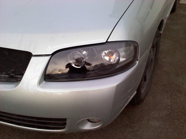

Custom retro fit FXRs projectors and harness from TRS
Prob. more I'm missing but meh.

RETROFIT BY ME

This year I've been putting some long needed TLC into my Spec v. New brakes, new air filter, new control arm, and replaced my wideband cause I needed a new af sensor anyways. Also setup a new pcv system in the car with a vented catch can. So I upgraded some things too. Running a innovate performance scg1 wideband/boost controller now and up'd the boost. Working on the tune on my way to and from work now.
Car has been on 7 lbs of boost for the past 80k miles. So far I'm pushing it to 10-10.5 lbs. Tunes going well and I've still got plenty of injector left. Not sure how much I'll push it. Car will prolly be making 320whp on these levels once I finish my tune. That's pushing it on these internals at that point. One hiccup at those levels and its tossing one if the pencil thin rods.
So here's a few shots of it this season so far. I'll work on looks eventually. This car has always been about all go, no show. It's a driver, meant to be beaten and driven.
All the interior pods are one off stuff made by me. The new innovate scg1 has replaced the innovate xd16 wideband spot on my steering wheel column. Everything else is same inside.
Actually running an intake again on the turbo...I think it's thanking me. Haha
Scg1 ebc solenoid mounted on head bracket that use to be a mount for an engine cover when it was stock.

Catch can location. Works well since my hoods ventes in the rear so the filter vents right out the hood. Less oily vapors in the engine bay..
