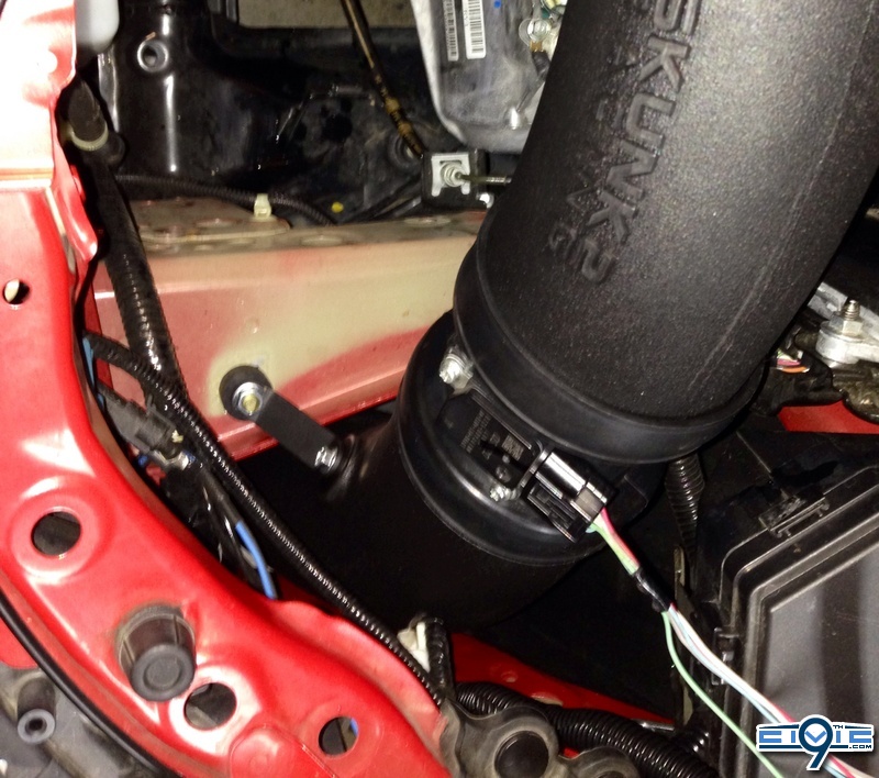

Install the supplied bracket adapter into the upper forward factory battery tray bolt hole HAND tight. Install the supplied bracket onto the bracket adapter using supplied nut (do not tighten yet) and then secure it to the lower intake tube with the supplied bolt (do not tighten yet).
Position the MAF housing so that when the sensor is plugged in nothing is interferes with the wiring. Situate the remainder of the intake so that you have proper clearances in the needed areas (avoid rubbing/ rattles).
Tighten all of the intake clamps and the lower intake tube bracket snug but DO NOT over tighten (superhuman strength not required here).

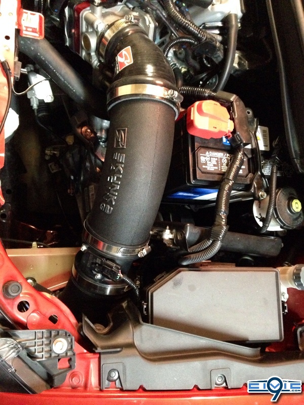

ALMOST DONE!! Connect the supplied silicon breather tube to both the upper intake tube and the valve cover.
Place the battery onto the battery tray but do not slide it all the way into it.
Connect the negative battery terminal (do not tighten yet) and plug in the 2 wire plug we extended to reach. Slide the battery all the way down into the tray and arrange the negative terminal so that it doesn't rub on anything then tighten the terminal.
Install the battery tie down.
Connect the positive battery terminal and tighten.
Reinstall the inner fender well and the wheel then lower the car.
That should do it!

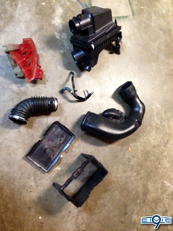

Parts that we did NOT reuse.
That should do it!
