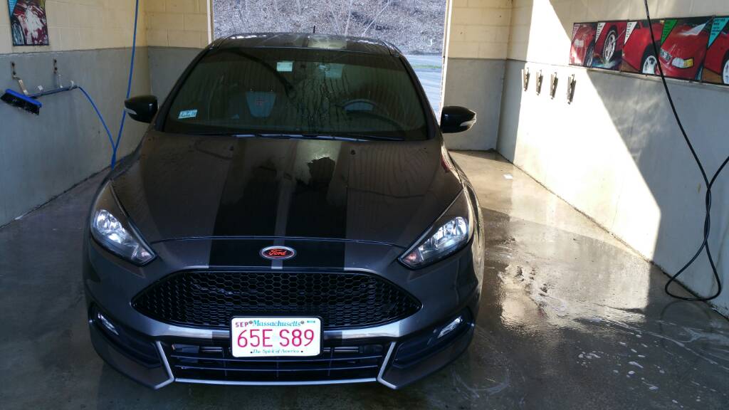

Yes. There are special products made for matte finishes. You run the risk of damaging the flat look and making those areas smooth and shiny.
@nat3d Dr. Beasleys makes the best products for matte finishes (Protection and decontamination) For washing and Maintenance I would use Chemical guys Matte wash.
Thanks man. My car has matte vinyl stripes and their kinda annoying to take care of
Don't cringe too much that I did it at a public wash. I had to do something for it as it was filthy and I'm not in my new place yet.
Any touchless bays around? The biggest issue is the brush at the bay. That's where swirls and scratches get into your paint.
I like your stripes. I have been tossing the idea around in my head to add stripes to my car. I was thinking about adding black stripes to my PMM car. I thought it would look pretty cool.
Like webby said, the brushes are the worst things about these washes. You don't know what the last person did or washed with them. I know people that bring their own mitt and bucket with a grit guard to these places which helps.
Nice car and yes, the matted stripes can get frustrating to maintain from what owners that have similar set ups tell me.
I've done that a couple of times in a pinch. I just would go to a place with a ton of bays at a really odd time, so no one would say anything or be waiting on me. I'd rinse the car, shoot soap all over, then fill up my bucket. I didn't sit there and detail the car for a long time, but I knew it had to be better than the brushes. I've seen people take mud and whatnot off their 4 wheelers, jeeps, and whatever else after offroading.
Yeah but it never takes care of the hatch imo. What I did was just used the brush on my glass and held it over my car for the foam.
Thank you man! I didn't like them at first then after having the car an hour I fell in love lol.
This will be the last time I ever use one because I get in to my new place the 14th and I'm getting a pressure washer once I'm in so I'll never have a need to pay for a wash again.
A lot of people think racing stripes only look good on muscle cars, but I think they would look good on the civic too if done right.
I like the single offset stripe or a large and small offset dual stripe if that makes sense.
But frankly man if you like it on your car screw what other people think. It's your damn car.
