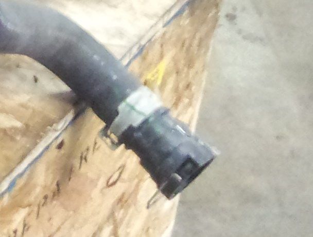

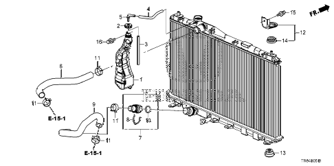

I'm sure the lower rad hose releases just by pulling the spring clip out of the rad...
Just pull out the clip #8 and bam! Its off! Then you take the hose clamp off once the hose is in your hands!
Looks simple in theory, but accessing it is not. Possibly taking off some of the lower bumper cover would help, but there is still the frame to deal with.
Its easier for sure if you remove the splash shield and remove the clip from underneath. I've had a couple off...
Well, I'll be damned if I wasn't able to actually see that little clip while underneath the car! I will make sure to point that out when I post up the DIY. With credit to you for pointing it out of course.
