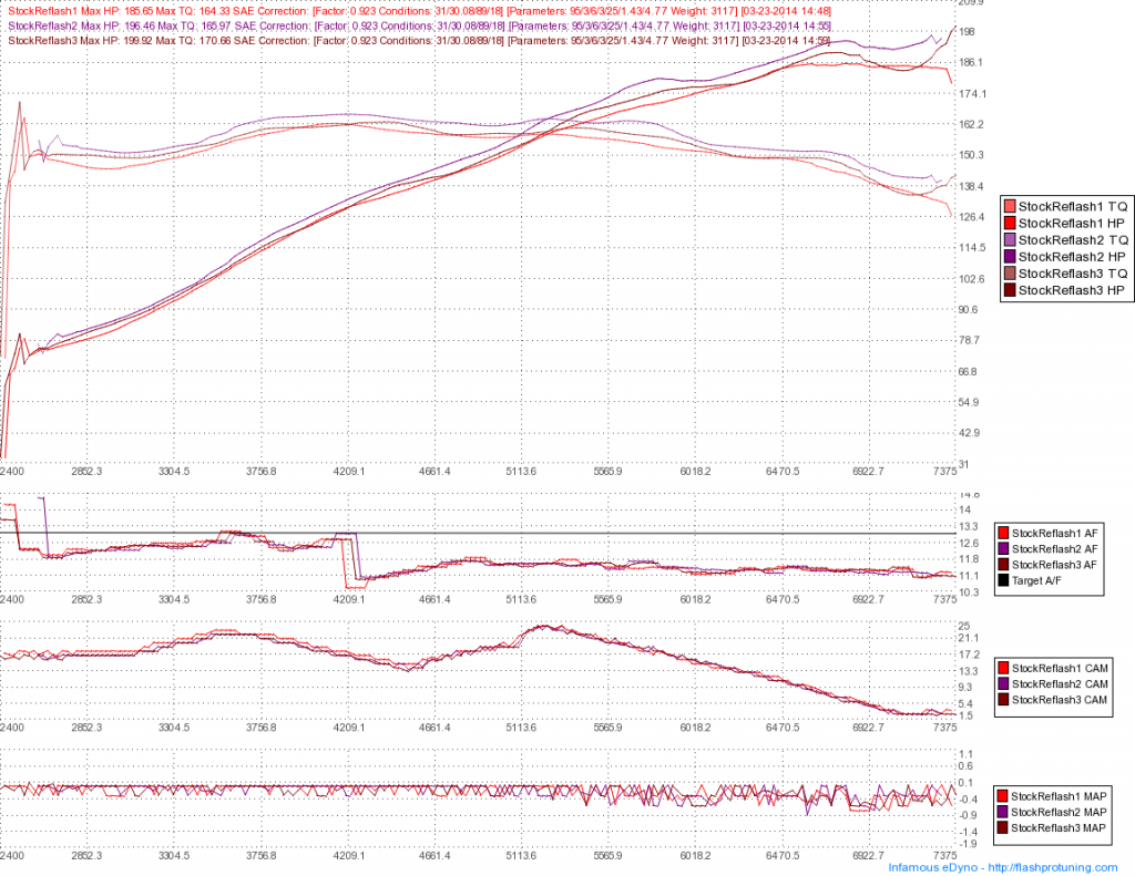

I finally got a chance to test out my flashpro and used the reflash basemap. I used Vit's smoothing log for this graph. I have a K&N Typhoon SRI and P2R TBS. I was actually surprised to see these numbers on the E-Dyno. Let me know what you guys think. :D
just the intake and throttle body spacer and you hit 199hp/170tq? Those are great numbers if I'm reading them right
Well, hoperfully it'll be the same outcome when i put it in an actual dyno.... :D This was on a 3rd gear pull with 93 octane.... The only thing is my gas mileage kinda sucks now... :D
Just realized your A/F ratio is like 10-11 from like 4k onward because it's the reflash map & not a tune from vit. It's running really rich. You should talk to @VitViper about a tune.
