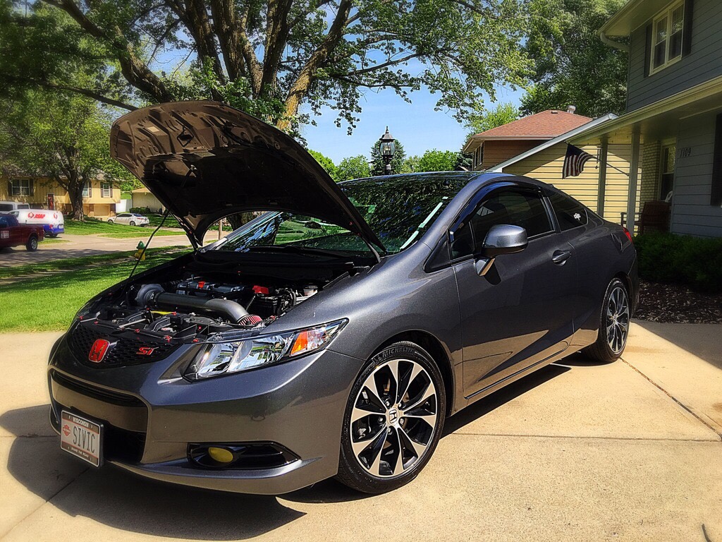

Love the post...been reading for a while now...I'm ready to buy my Kraftwerks Supercharger kit. Right now my car is bone stock(lowered on coilovers), and makes nooo sense to do anything without Flashpro. So i saw the full kit from ProCivic (http://www.procivic.com/pages-product_car_part_info/category-70_163/product-2500/index.html) including flashpro, purposely didnt mess with my car because i didn't want to bolt anything on without tuning.
So my question is, from my bone stock can I slap this one, tune and be reliable? After which get the upgraded fuel pump, clutch, cat back, colder plugs etc, and retune, and continue building just fine?
Last thing is, I haven't seen, Do you have to relocate the battery on the 2012 model or should the kit fit (Ha I rhymed!)
Any guidance (and bashing) is welcome.
My lil cutie is attached :D

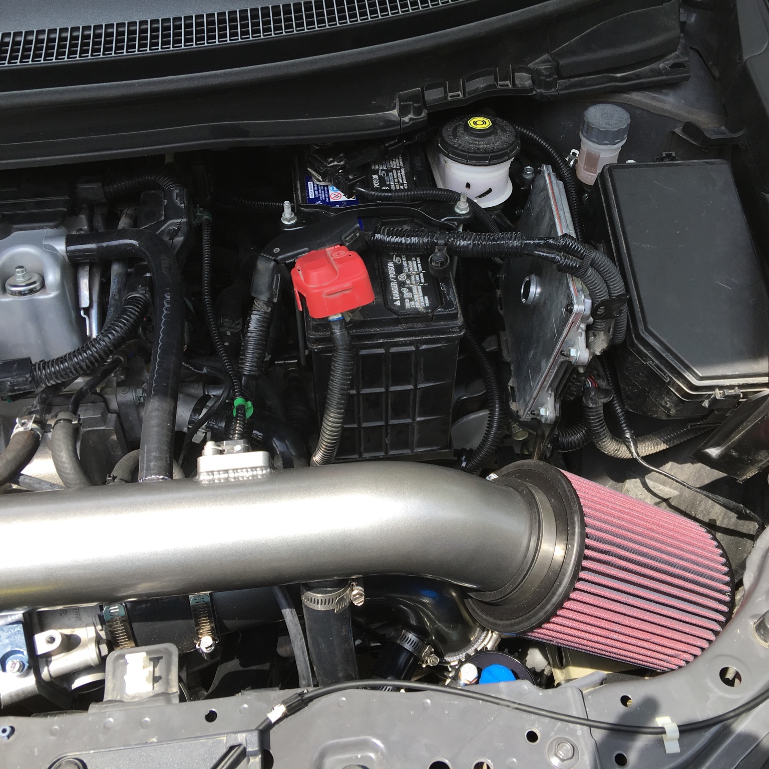

Nice car man! She will look real nice when you are done. The battery will be moved with the Kraftwerks kit. My kit will be officially installed this Monday-Tues. I can't wait!

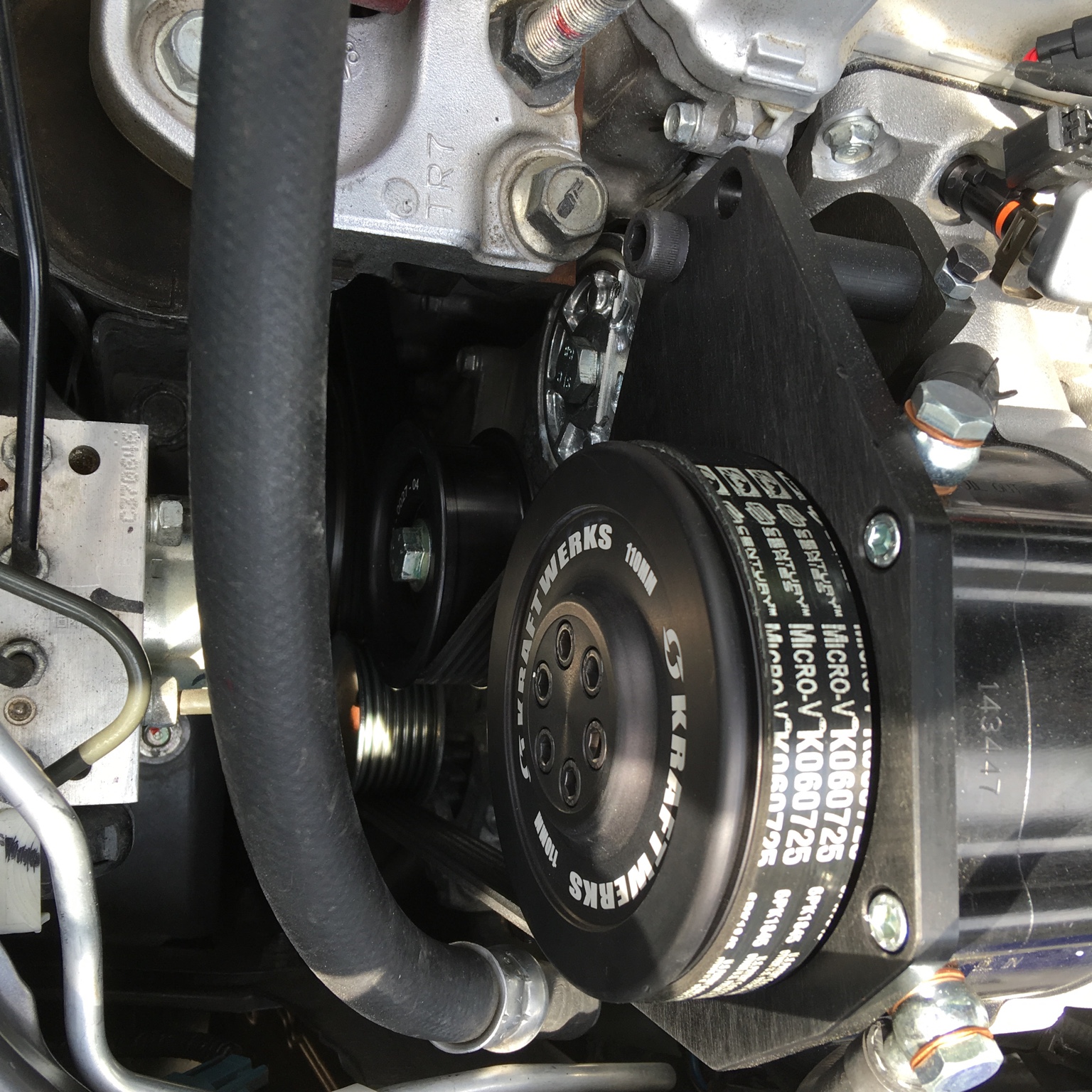

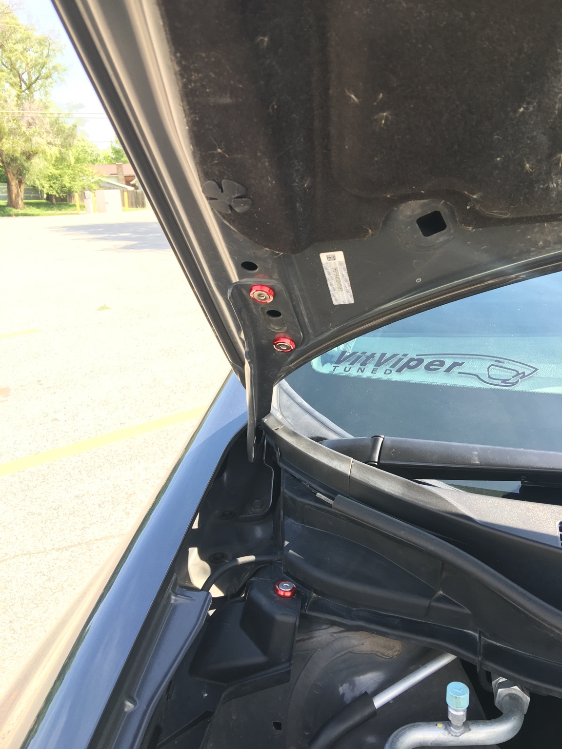

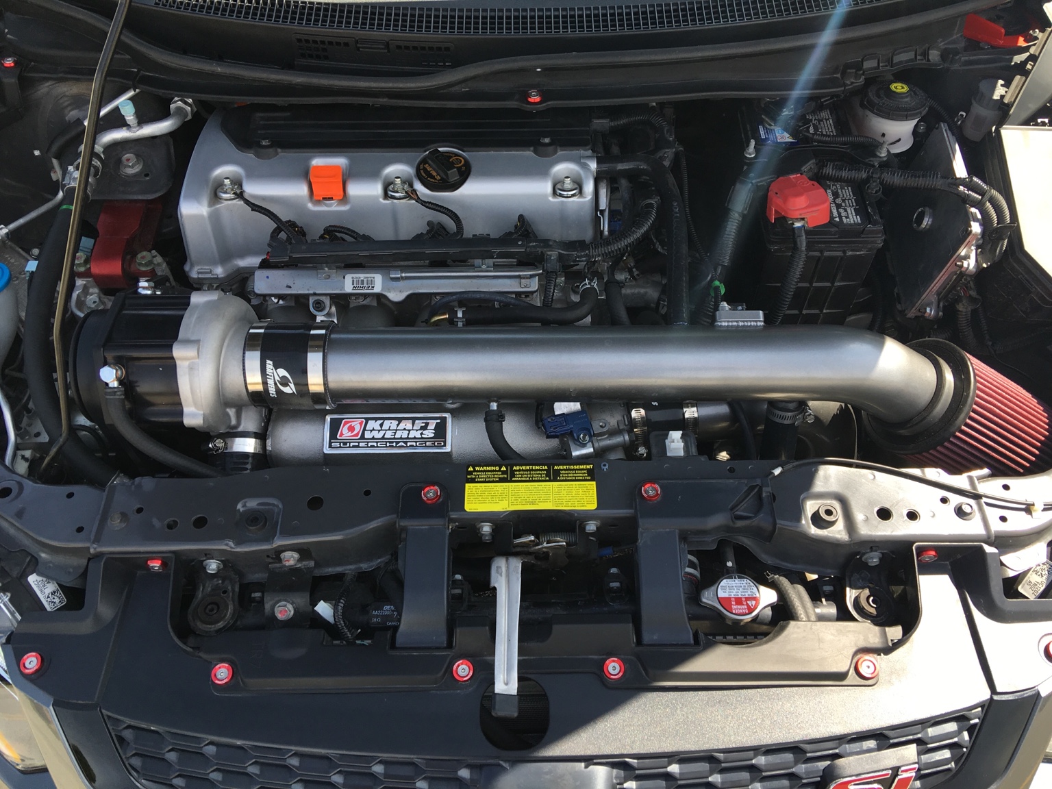

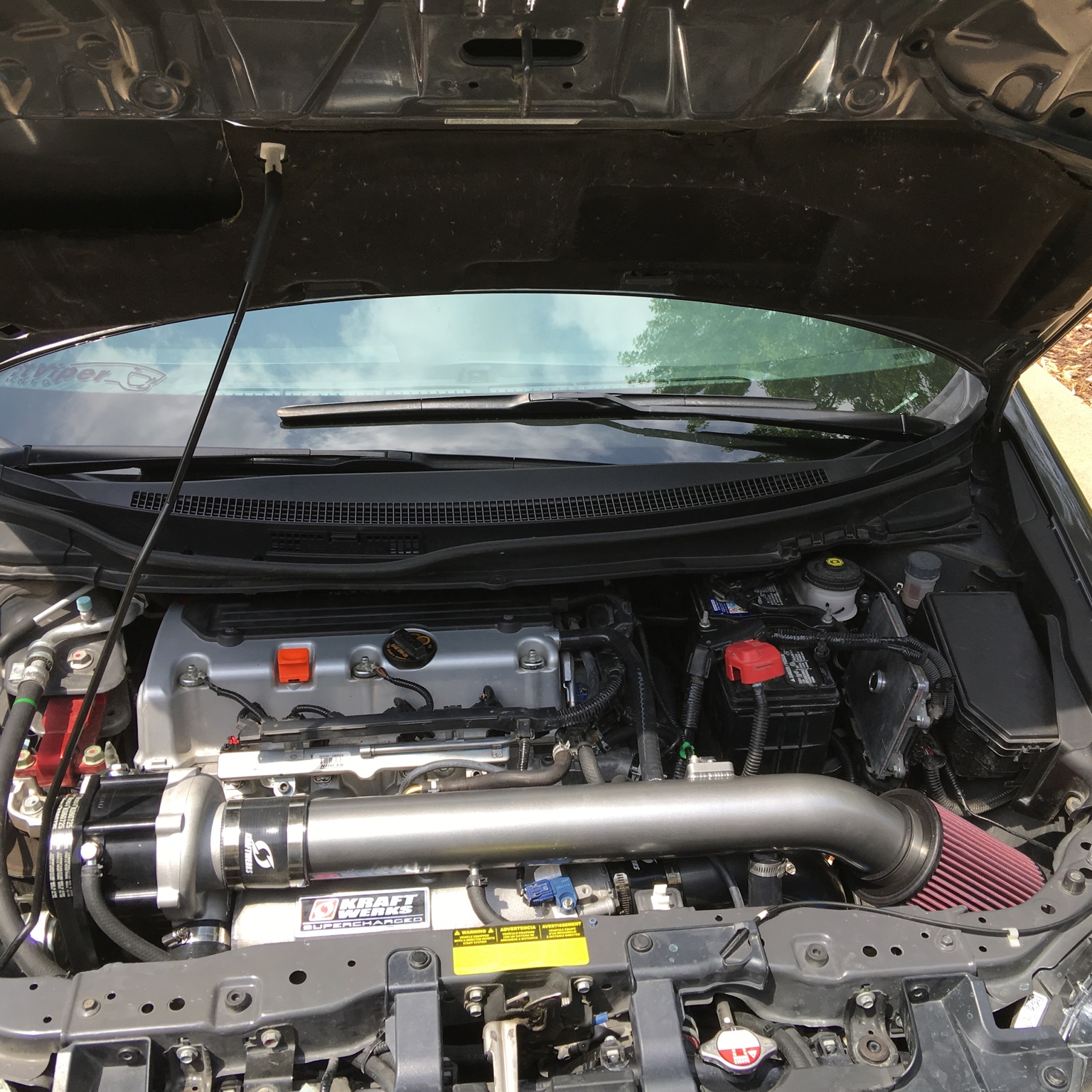

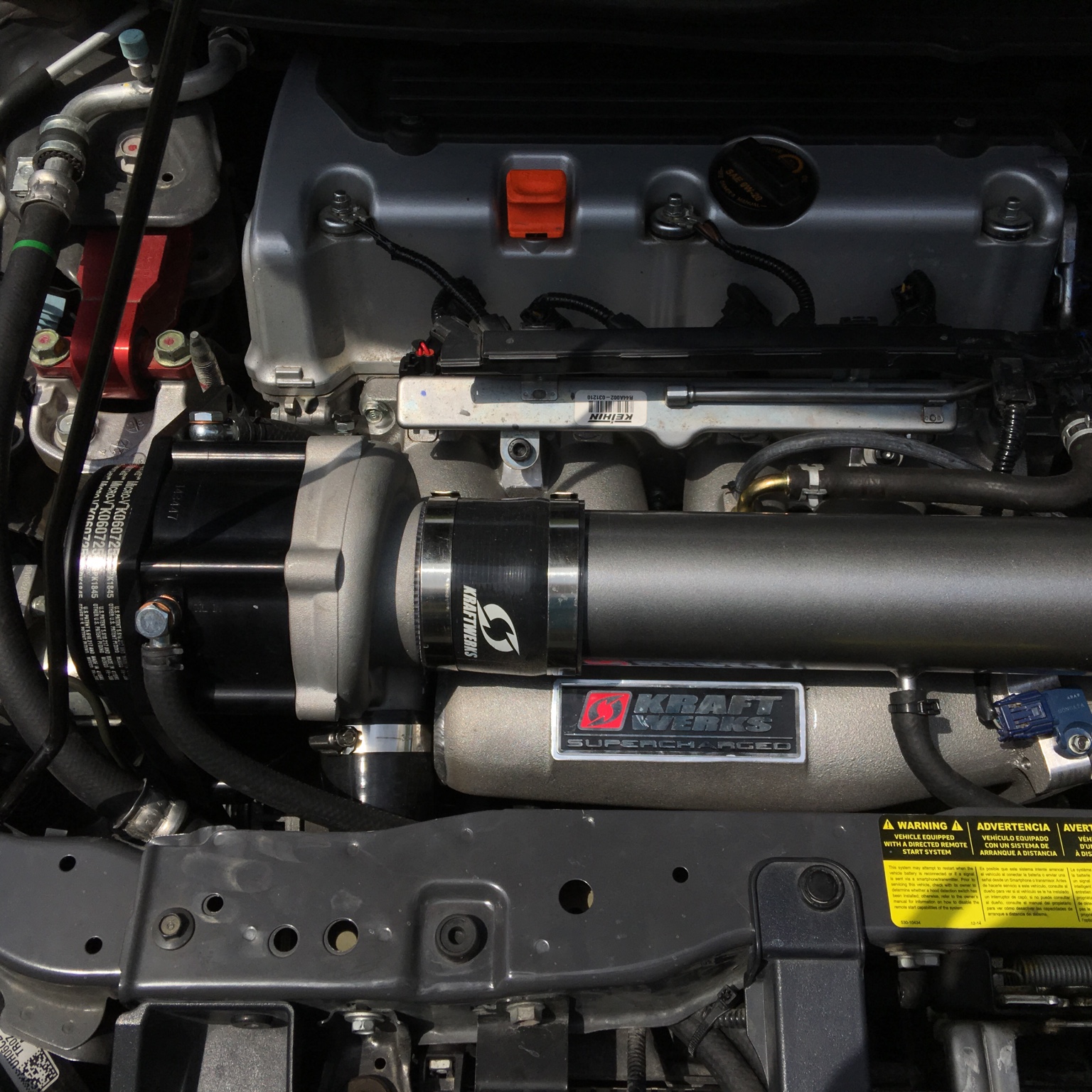

Here are some photos of the Kraftwerks install so far...
