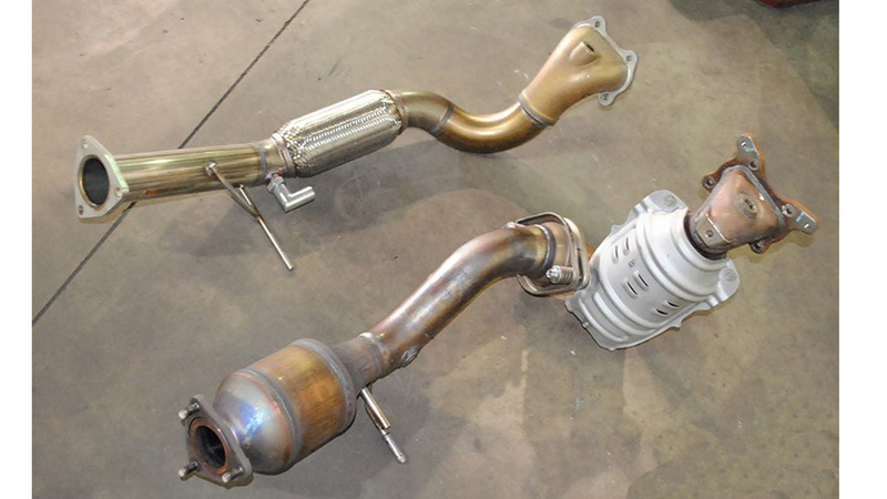

aftermarket downpipe top with no catalytic converters / stock downpipe with 2 catalytic converters bottom.

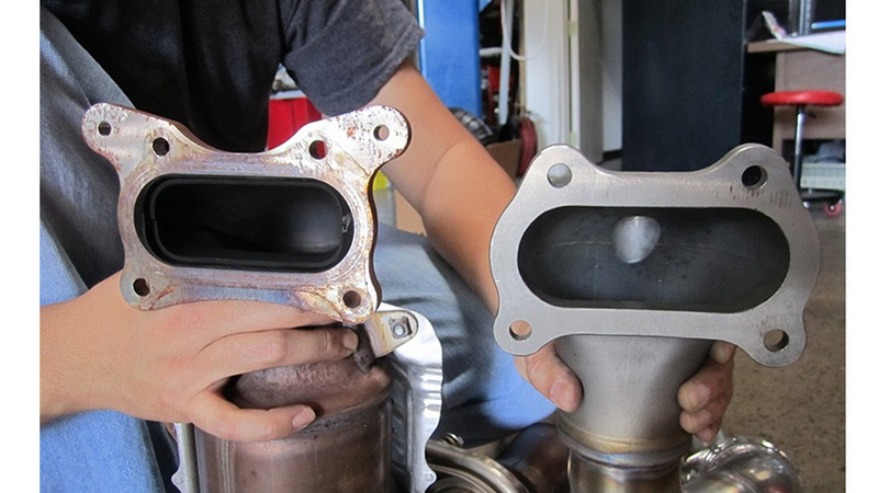

inlet comparison / stock vs aftermarket above

The best thing you could do is have hondata flashpro with a tune...and a downpipe & catback exhaust. That combo would yield the highest numbers. The axle back would yield the least results.

Turbos are not N/A they are F/I. There are dp for the civic, pictures above.
Cat backs are midpipe resanator and axel back bolted to the cat. 1st picture webby posted has the two cats. the one closest to the bottom is the one you would bolt the cat back to.

Normally, NA cars don't have downpipes since the exhaust side of the head will have outlets connected to a header, or headers depending on the engine size. The 2012 Si's K24 engine is an exception with having a downpipe since the engine's head has an integrated header collector on the exhaust side which has only one outlet.
