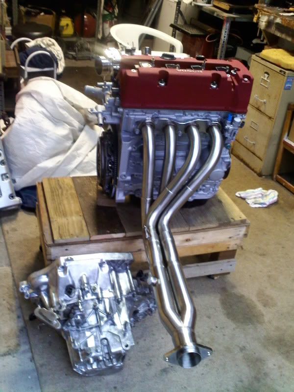

Normally, NA cars don't have downpipes since the exhaust side of the head will have outlets connected to a header, or headers depending on the engine size. The 2012 Si's K24 engine is an exception with having a downpipe since the engine's head has an integrated header collector on the exhaust side which has only one outlet.
I know this is a late post on this but can you go into more detail on why we have downpipes or how what you said works?
The exhaust side of the K24 head is collected into one outlet. For example:
While the K20Z3 has 4 outlets (one from each cylinder) on the engine head:
It all makes more sense now!! That's why we there's no aftermarket exhaust headers or manifolds and thats why our's is integrated correct?
Pretty much. Aftermarket downpipes are offered for the 2012+ Si's though.

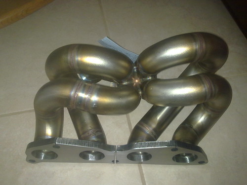

Ok last question, why do turbos have it? Is it so it has unrestricted airflow into the turbo for the exhaust gases to power it? If so can you show me a picture too?(I'm a visual learner)
Well, with a turbo charger, the total collected outflow from the engine goes to the turbine which forces more air going back to the engine. Since the K24 already has one outlet (total engine outflow), a turbo manifold would be simple in design. Turbo manifolds are used so the total outflow on an engine will be directed to one outlet.
For example:
^This turbo manifold K20 example collects the outflow to the turbine.
An example turbo manifold for the 2012+ Si would be something like this:
