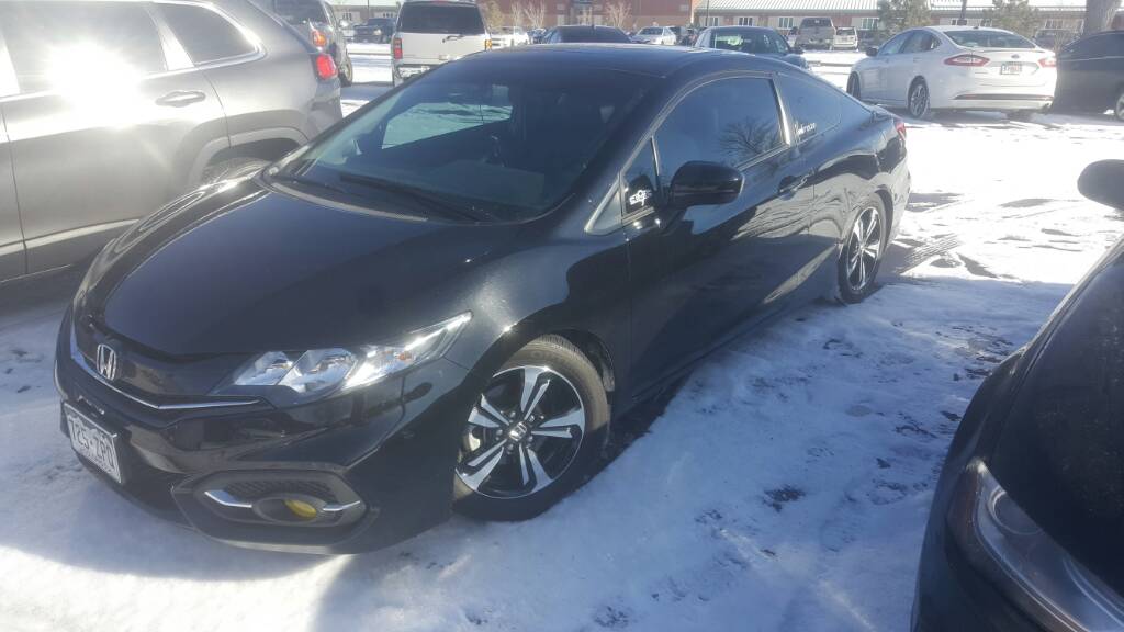

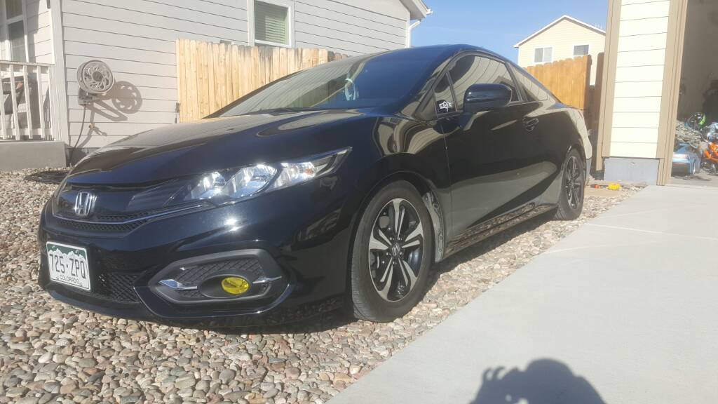

Here's a couple shots of mine on ex wheels with a 2" drop. I could use wheel spacers like webby said to get more flush, but I think at least in the front I'd have rubbing issues.
Is it a thing to do spacers in just the back then? Lol
Thanks! Offset on my wheels is +35, full specs are 18x8.5 +35 225/40/18. Im not sure what the specs are on the oem EX wheels.
My flares are whack lol.

Im on D2 springs, with 18x8.5 +35 225/40/18. That's pretty much flush without retarded negative camber, its functional. I did have to roll and slightly pull my fenders though, but no rubbing since then. I do plan on going 18x9 +35 later on and going a little lower but still trying to stay functional.
What rims are these? Can I have a side shot? I like the look
Was debating on getting skunk2s now or should I go for the D2s? How's the bumpiness on both
