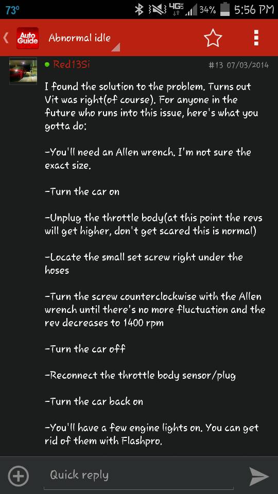

Have you tried this?
No I did not even know about that but whats funny is I was just looking at that bolt...
Just did this that screw is one there pretty tight its easier to get at if you take off the manifold cover.
Mine is idling just a hair under 1,000 that bolt will strip out don't wanna mess with it to much.
Ya that sounds like you have something else going on other than this lol mine was just a slight jump in rpm's
I finally got around to getting the screw fully adjusted today let me be very clear in order for this issue to go away you need to follow the guide that was posted above and when you are adjusting the screw the RPM'S need to be at 1400 on the mark or you will still have the idling issue it needs to be precise nothing more nothing less. Also make sure the car is warmed up.
