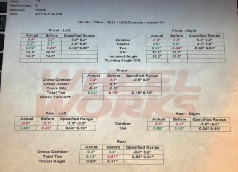

JoeLiu lowered his car and did not run camber kit in the rear and no camber bolts in the front. He did post his alignment sheet and you can see that his fronts are way off: One side Positive camber the other Negative. Both rears are over -2.2 degrees. This is on coilovers but he is at about a 2" drop.
got an alignment. probably going to run without a camber kit for a while, no moneysss
