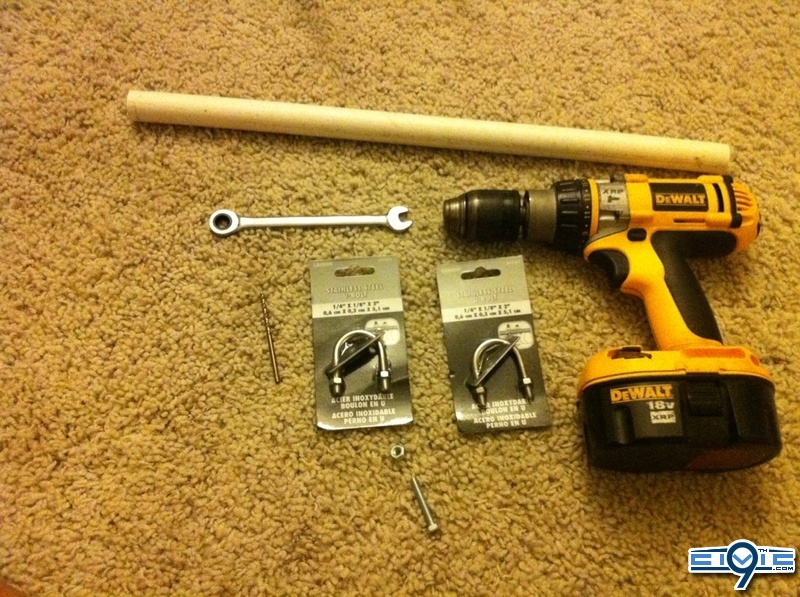

I paid $6 bucks after tax for the bolts and U bolts.
I used PCV piping to start out, but will make a metal one later.

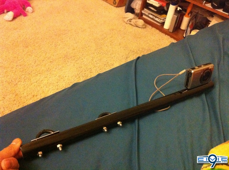

Bolt size for the tripod hole in the camera is 1/4-20.
I know this isn't the best DIY, but I just wanted to try it out.
I did this DIY in about 10 minutes and didn't take my time.
I just wanted a quick project. I went to Home Depot and picked up a few items.
Items I used:

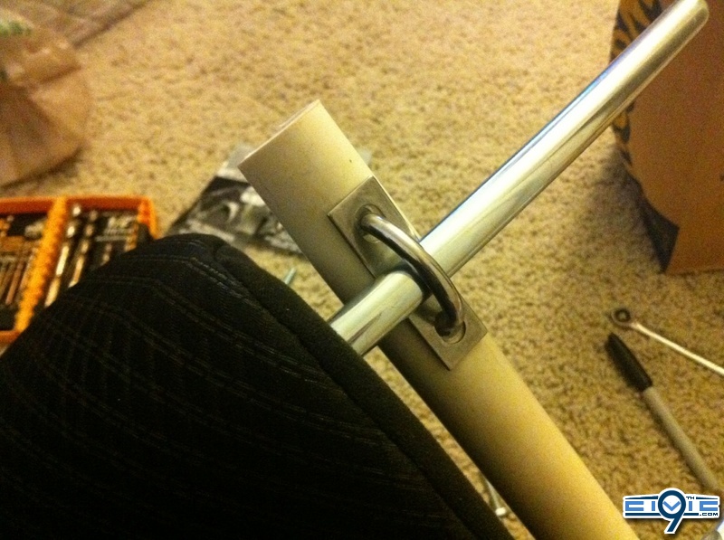

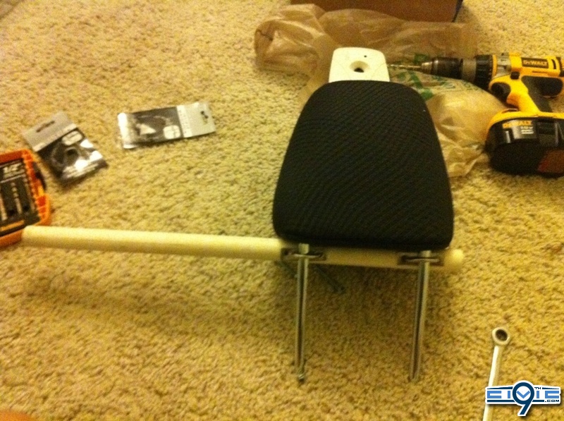

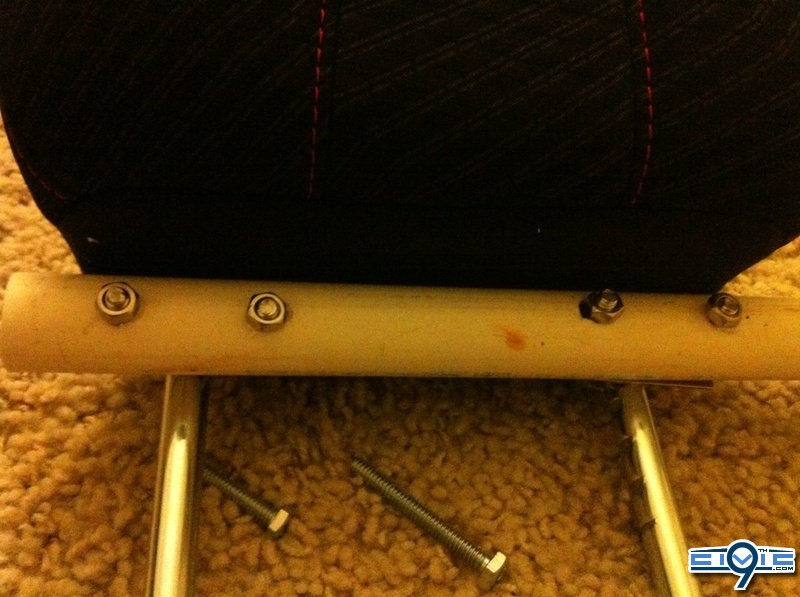

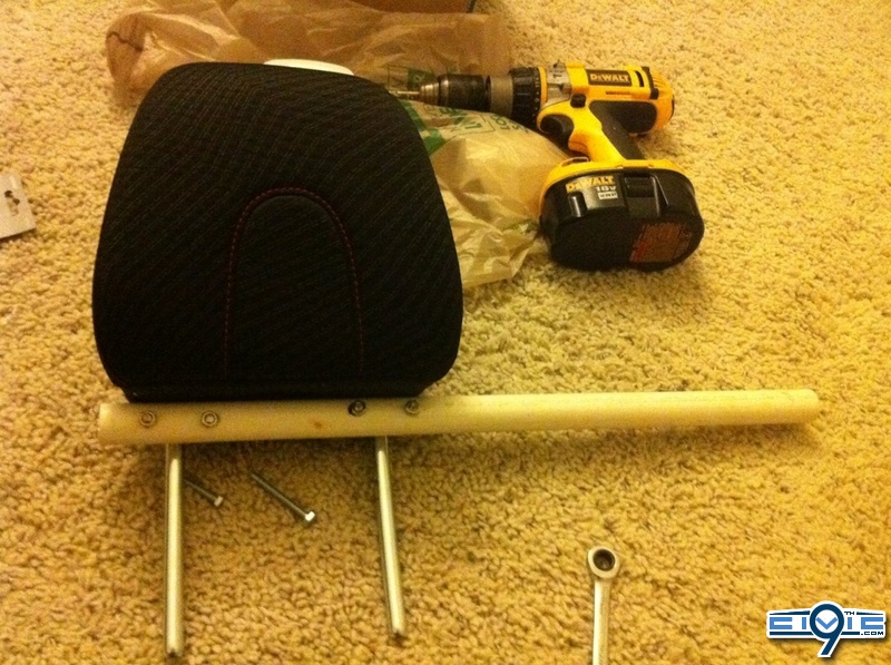

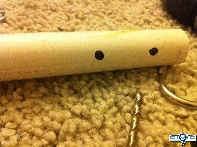

I took out our head rest and lined up where I will drill my holes and marked it.
I drilled the first two holes Tested one side on

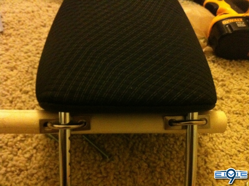

Do the same for the other side(line up and mark the holes)
close up
Further picture

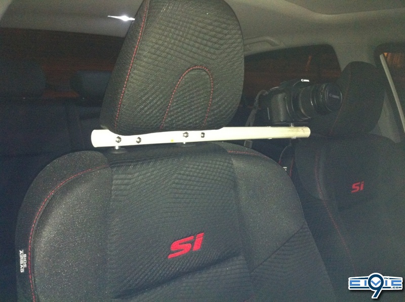

In the car(I know camera is not straight and aligned. It's adjustable.)

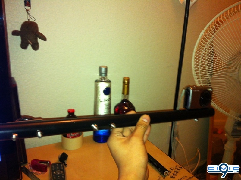

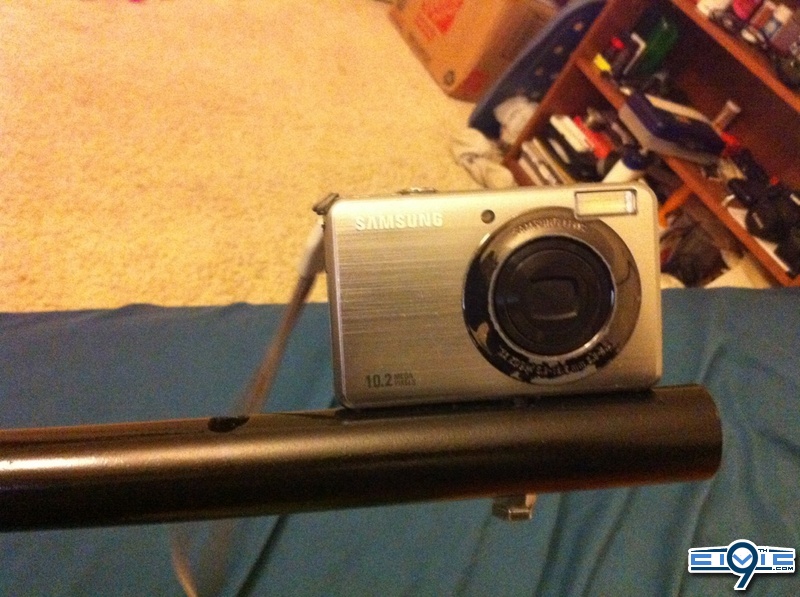

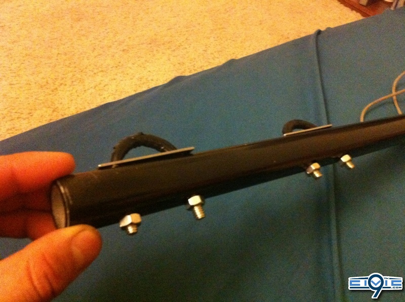

I got bored, so I painted it black, and put electrical tape around the U bolts to keep it from scratching the head rest.
Overall, for $6 bucks, It worked with my budget.
It works good so far. A little bouncy when taking off, but I am pleased with it.
I just need to make one that faces my passenger window now. Here's a quick video of it in my car.
I didn't bolt it to the head rest, just finger tight so, its bouncy.
Just hoping onto the freeway.
