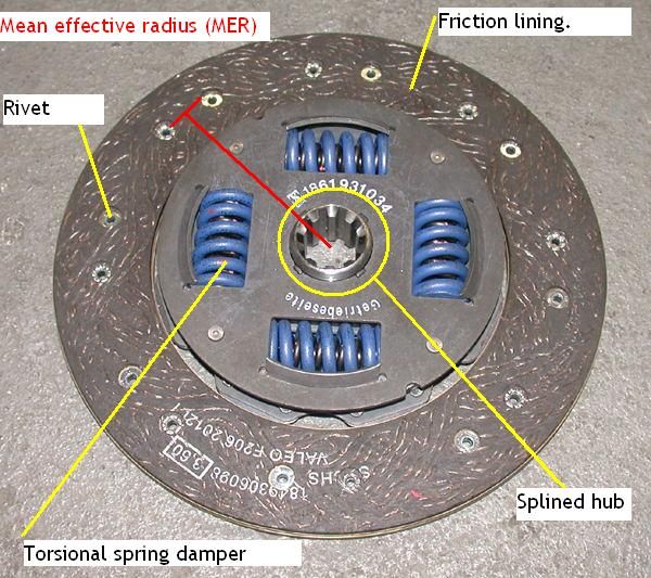

In all likelihood the clutch disc is broken - just like the op's clutch was.
What happens is the metal in the center of the disc that houses the torsional damper springs opens up due to repeated shock (usually due to hard shifting). The result is that the springs rattle - usually heard when taking off in first gear. Worst case scenario is that one spring falls out and jambs between the disc and pressure plate. I have seen this already on too many '12 up Si's and wouldn't be surprised if "rev hang" is a contributing factor as the hang seems to be worst right about where the engine makes maximum torque - so you wouldn't have to be beating on it to cause a failure. Just a theory.
