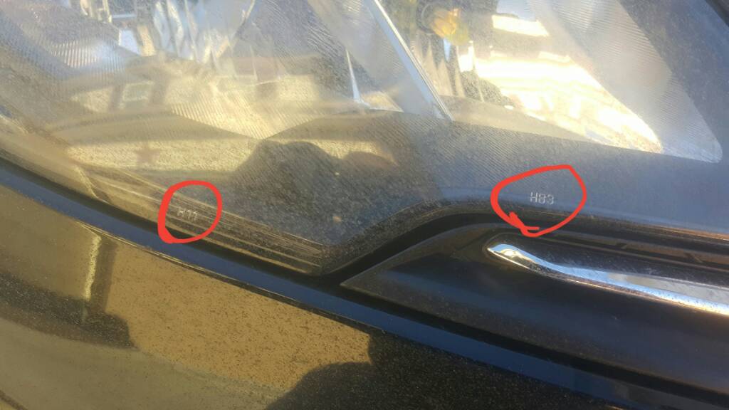

I also noticed today that Honda has etched the bulb type on the headlight lens for my '15 coupe. Never seen that before, may be there on other, not sure

This is what I was talking about
