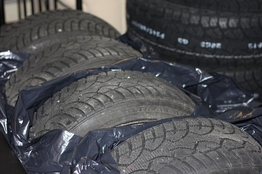

After living with these tires for a while I figured I would write up a mini-review. We have more than a few inches of snow now, and every morning I have to punch through the wind row left by the sidewalk plow, as well as from when the street was plowed. Never have I felt that I wasn't going to make it, it's like a 4x4 in the snow.
I ordered these tires studded, although I am not sure I will do so again, as the amount of times that studs are actually needed, are few and far between, and the downside is a big increase in noise, more noticeable at lower speeds in the city.
These tires are soft.... very soft. Driving fairly spirited in cold weather resulted in a hot rubber smell when I got to work. As far as wear goes, I have around 2000 kms on them with negligable wear. The tires self clean easily, and give very good traction cornering and braking. I have experimented with the traction control on, and I have to say that I am not a fan, as it is overly sensitive.
That's my 2 cents on these tires. Would I buy them again, yes, I would. Would I stud them.... that would depend on how much in town driving I am going to be doing. The traction on dry pavement is reduced with the studs.

It was near rain today, on top of about 3 1/2 inches of fresh snow, and I didn't have a problem at all with traction, was almost like slush, but a bit stiffer in consistency. The car never spun a wheel, although I could have easily done so. I know that with the stock all seasons I would have been stuck today for sure.
The sipes really help out, as does the open side slots on this tire, just check out the pictures I took from this afternoon. If the tire were any more aggressive, it would displace snow more, but there are a lot of times where that doesn't help you. Packing the snow, instead of acting like a paddle is a far more efficient way of creating forward traction.
From that last picture, it looks like I may have to drop the pressure slightly, as the siping is more noticeable in the center of the tread.

March 25th 2013 follow up:
Just stopped and had the engine oil dumped, was at 20% oil life today. The dealer's quick lube shop checked tread depth on all 4 tires and noted the pressures were down a bit.... I haven't checked them in a few months. Soon time to install the stock all seasons, was going to do it this weekend, but had other things to do on Sunday, and had to work on Saturday.
Front left and front right measure 11/32", they come with 12/32" over the wear bar. ( 14/32 if you don't measure at the wear bar )
Right rear had 13/32" remaining, and the left rear had 12/32".
Actual mileage on the tires is about 7466 kms, I put them on around 670 kms. I have driven some highway miles at higher speeds early on in the winter, as well as I drive fairly hard in the city. From the looks of it, if I rotate them once during the winter, and keep an eye on the pressures I might get 3 seasons out of them the way I drive.
The studs are still fairly sharp as well, this is surprising.
