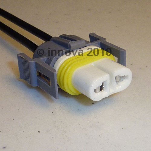

While installing the fog hid kits, I noticed that the plugs do not "click" together like my low beam kit did. After further investigation, I found the reason it was not securing properly. The prongs on the ballast plug are wider than that of the factory plug. Any input from X.D. or anyone willing to give advice would be great! Unfortunately I'm going to have to put the bumper back on that was a pain to get off, as it is too late to finish now. Damn.

Yes sir, ordered the H11 kit for the fogs and it also states on the box that it is H11. Needless to say, I'm left scratching my head. Lol

Yes, the kit is by Xenon Depot. Plug on the right is the factory and the left is the ballast. Notice the difference?

I'd need to see the ballast I guess. That's a male connection on the left. Is there not a female h11?
Not sure if you have called us to resolve this yet or not, but thought I jump in and help out.
Are you trying to connect the ballast connector directly to your stock harness? If so that would be why its not working. You should have received an H11 connector with the HID bulb which is what you connect from the ballast to your stock harness.

OOOOOK! So I'm finally back in town and apparently I'm a schmo! The kit did have the appropriate connector. Went on without a problem and should have pics up shortly. Thanks!
