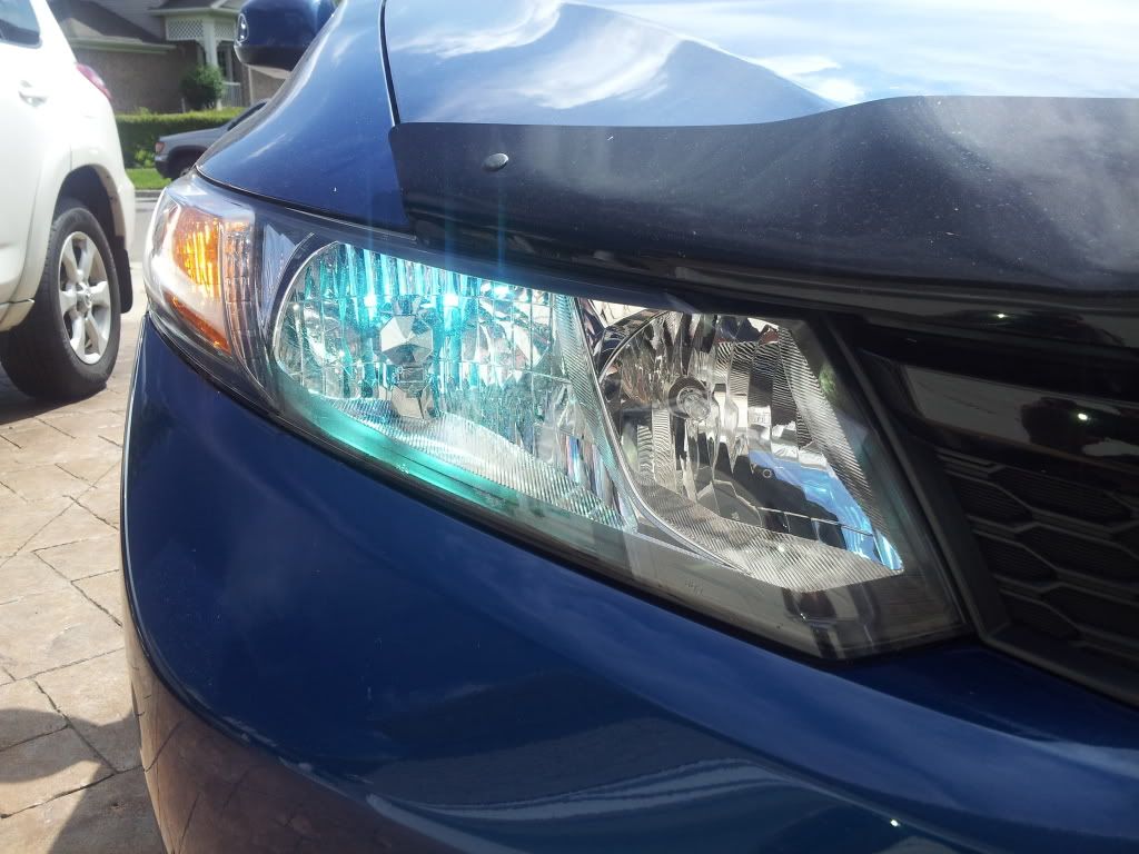

this is from @The Si Canuck
stock halogen
his hid install

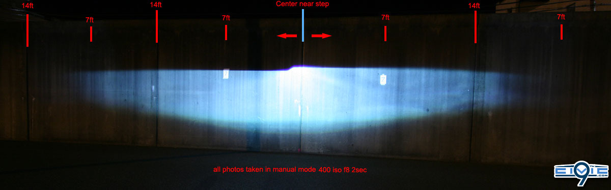

It's nothing like a retrofit, but it doesn't seem "horrible". I've not seen it from oncoming traffic to really say for sure though. Mini H1 retrofit comparison below

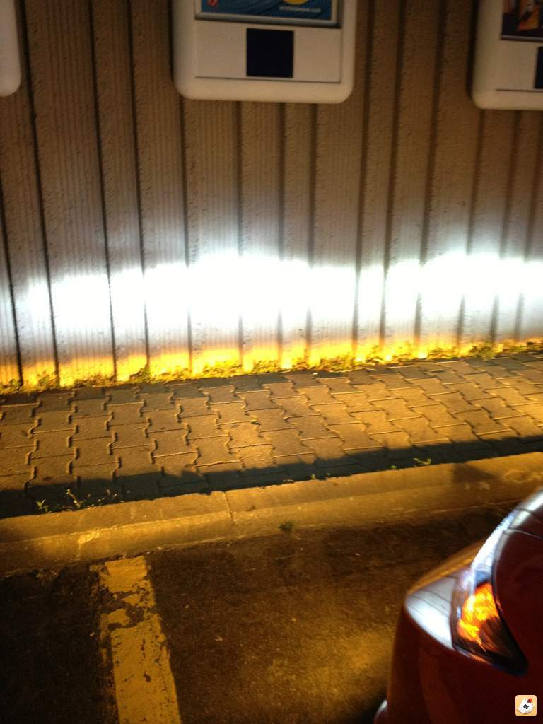

I agree, this is my cutoff..
