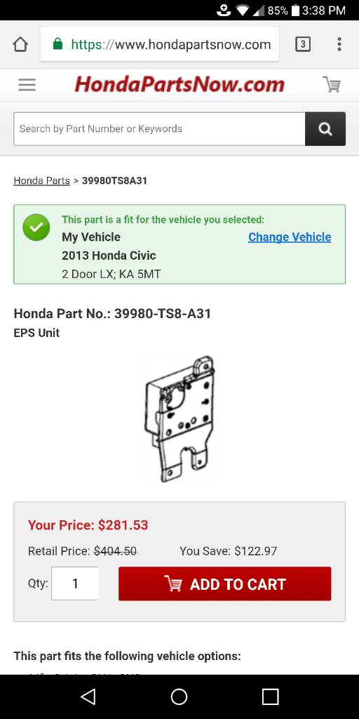

Glad it helped! I am waiting to hear back from my sister who is searching my old room to find the paperwork from when my power steering module was replaced, hopefully there is a part number of some sort that i can search to help you find a used one.

After finding out the part number for my EPS unit based on the paperwork from when it was replaced, I was able to do some digging and managed to find the part number for yours. It's specific to the 2012-2013 LX Coupes with a Manual. Here is the link to this website :https://www.hondapartsnow.com/genui...t=1,5;et=2,3)&Location=control-unit-cabin,,13 there is also a diagram that shows you how to access it. Here is a pre-owned one on eBay for reletively cheap https://www.ebay.com/p/Honda-OEM-20...ontrol-Module-39980TS8A31/1665278613?thm=3000

Wow, thank you so much fg3! GREAT information!
I'm headed out of town Friday morning for the weekend so won't be able to work on the car again until Monday, but will post more then.
