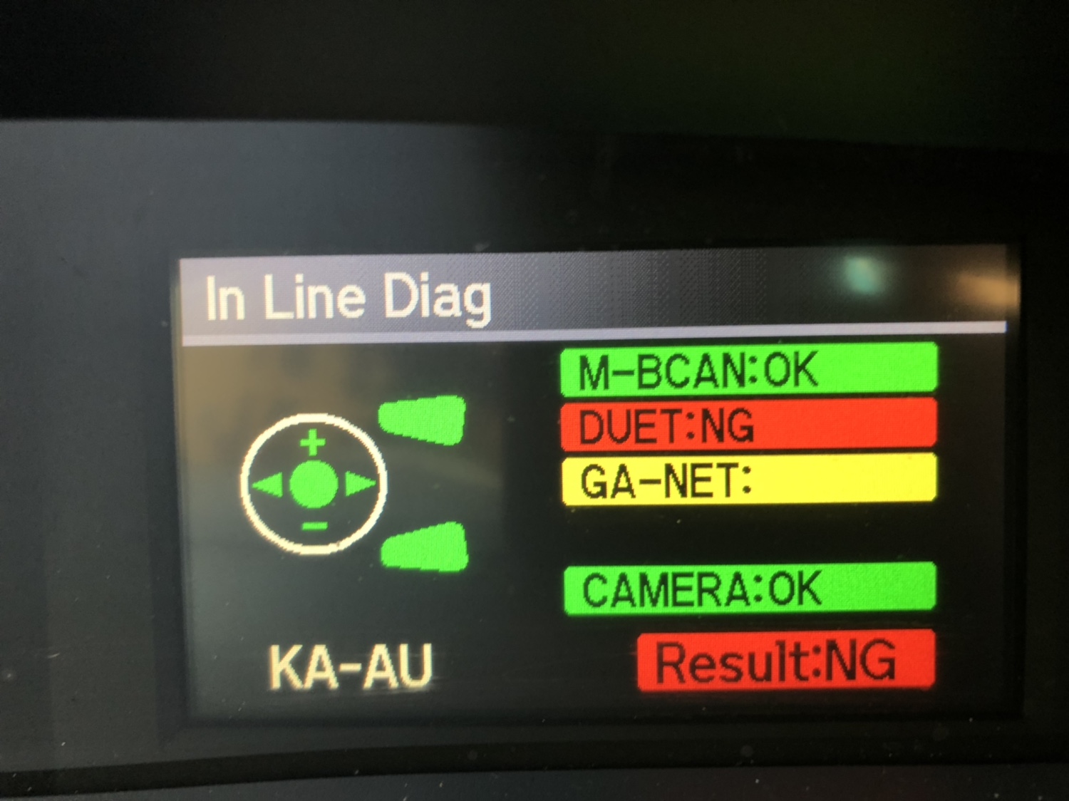

Hey guys I keep getting this screen, anyone know how to keep it from coming up? I was playing with my settings a couple weeks ago and selected the In Line Diag option, now this screen pops up every time I start the car. I know how to remove it once it comes up but I don’t know how to prevent it in the first place.

press on menu button, then press again and hold menu + 5 clicks on source
now press on in line diag option and set it on "complete"

Ok I tried it and it worked like a charm. You just made my life so much easier bro!

Hey all I have a 2013 civic is and I just put a new steering wheel and I now have the same in line diag screen on startup but it is permanent. I tried to do the menu source thing but it doesn't give me an option to set in line diag to complete. I need this screen for my backup camera. Any help would be appreciated.

How you set it on "completed" can you upload pictures? I tryed everything and I am still getting that screan, I dont see the complete option
