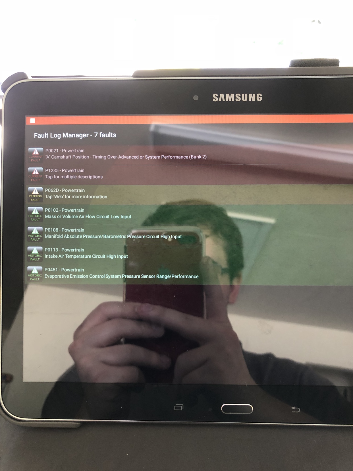

Long story short, friend and I just finished rebuilding the engine (FA20) for our 2014 Subaru BRZ Premium. Before the accident, owner said the car was running perfectly, and would even start after the accident. Now we can’t seem to get it to idle On its own.
It’s worth mentioning that we can get it to idle when spraying starting fluid directly down the TB. Now this seems like a simple fuel delivery issue, but unfortunately I think it’s more complicated. I’ve checked the fuses for the Fuel pump, ECU, Injectors (both bank one and two) and injection module (for some reason it’s separate from the ECU??) and they’re all fine. Even tested the fuel pump motor directly. So now I need y’alls help because I’m officially stumped.
Here’s a video and a list of OBD codes I could pull.

Things we checked shortly after my original post:
Vacuum lines coming from both the TB and intake manifold
MAF: verified it worked by testing the wiring and seeing the data it was sending to the ECU through Torque Pro.
Fuel pressure (also using Torque Pro)

@bootyluvr didn’t you have camshaft errors with yours? I know you had a few repeated issues the dealer fixed.
In regards to that, I forgot to mention that the timing code it threw uses data from a cam position sensor that was replaced with one that was marketed as “Brand new” and “OEM Equivalent” so it’s possible this sensor is faulty. We’re gonna try and get a working one from a friend with a BRZ to see if that fixes our issue. But any other suggestions would be greatly appreciated!!
