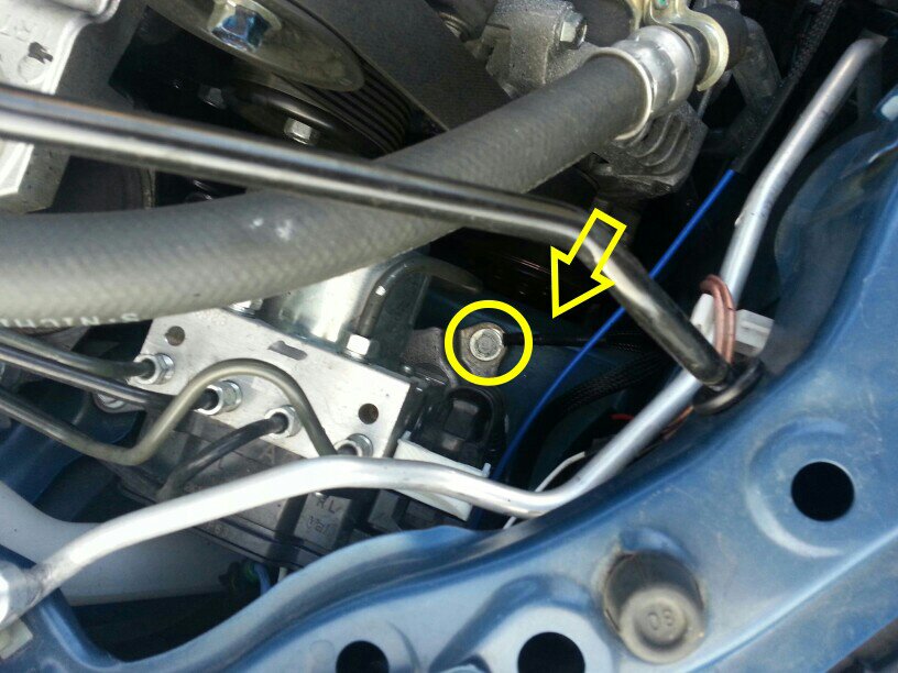

This kit came with 2 ground wires, one for each side. On the driver's side, I used the negative on the battery as the ground. On the passenger's side though, I used the attached image as my ground. It's not connected directly to the chassis, but on a metal piece. If you have a 2013 Si, you would know what I'm talking about. Could it be the reason that the passenger's side is acting up because that ground is improper?

i would try changing your ground, if possible you want the ground to be touching bare metal, not paint, Ive seen a decent number of people use a painted surface and end up with a bad ground. I dont have a service manual for the 9th gen, but somewhere nearby there should be a common ground point, it will be easy to spot because it will have a stack of ring connectors and black wires coming off them in every direction.

So it's not the ballast. I switched the ballast around and it's still the same side that's not working. I'll do a better ground next. I'll sand down a place and go to Lowes and find a bolt that'll fit into one of the existing holes.
