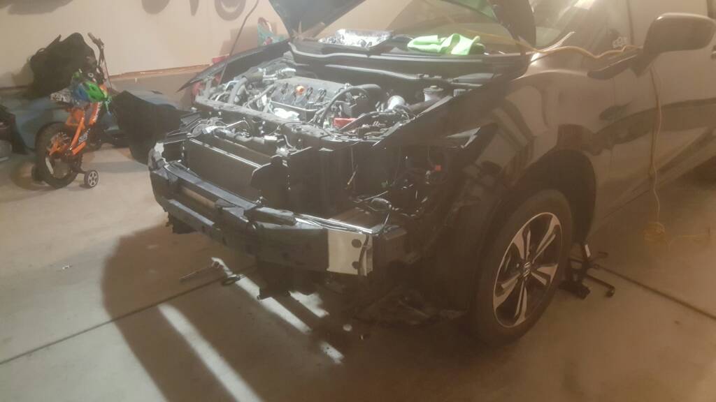

Let the clear corner/bumper enhancement project begin! Wife is outta town for about a week. I'll post more pics when I get more done...prolly tomorrow night some time.

Also true. Not too often I get under the car without my ramps. Just looked at the car lsst night and decided to go for it. Got the front.bumper off without the jack. Realized I had left part of the factory intake piping in place, so had to jack up to get that out from the bottom.
