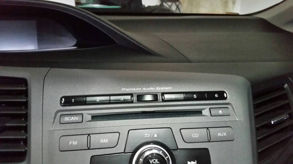

Does your radio says premium audio on top like this?
If it does you have the premium audio system. It has 7 speakers. If not you have the non premium 160w audio with 4 speakers and possibly 2 tweeters.

It does *not* have the "Premium" designation on the face. It is clear that the unit in my Civic is the non-Premium unit. I will look for a salvaged non-Premium replacement - hopefully one that comes with the unlock code. Installation does not look too difficult, with proper trim tools, so I may attempt that myself.
