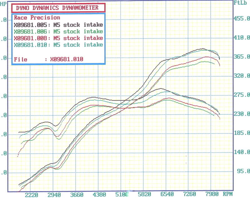

3 runs with a bmw m5 + baseline
it lost power in all 3 runs over stock.
http://www.m5board.com/vbulletin/e60-m5-e61-m5-touring-discussion/125499-afe-intake-dyno-review.html
005= stock setup
006= AFE Intake – RPI Scoops "blocked" – hood closed
008= AFE Intake – RPI Scoops – hood closed
010= AFE Intake – RPI Scoops – hood open
seems a bunch of owners did a mass refund, because it lost power.

wow that sucks! how do you make an intake worse than a stock one that is generally pretty restrictive!

I see. I went ahead and read about half that thread and got my own conclusion. It seems like that intake in particular was indeed a poor design. It was on a 2010 BMW m5, which was slightly modified. I doubt the modification had anything to do with the loss of power. Too bad, they have stopped production of that unit though, which shows it was a poor product. I'm still gonna do some more research but appreciate you finding that for me. It was an informative read.
