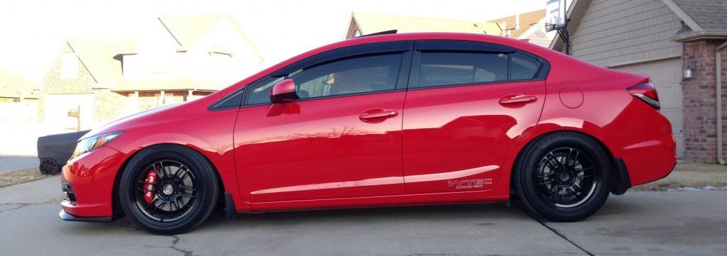

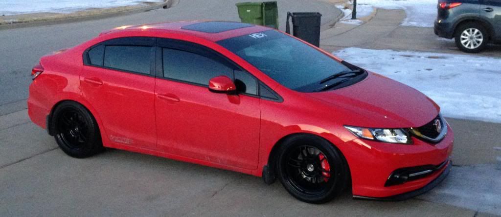

Some guy said that because i didnt use 13" rotors. My calipers are pointless. Lmao. Meanwhile i used s2000 rotors which are 299.6mm. And dc5 type r brembos which use a 300mm rotor.
^ he may have done some comparisons/research when he looked for his setup.
http://9thcivic.com/forum/threads/hi-everyone-im-sleepingpanda-part-2-lol.5584/page-6#post-226134

My brembo upgrade was the exact same for the 8th gen. So id safely say any brake upgrade for the 8th will work for the 9th.
But since no one has done it. You need to be the pioneer. Lol. It sucks. But how do you think I felt when I bought $800 brembo calipers without knowing if they'd work.
