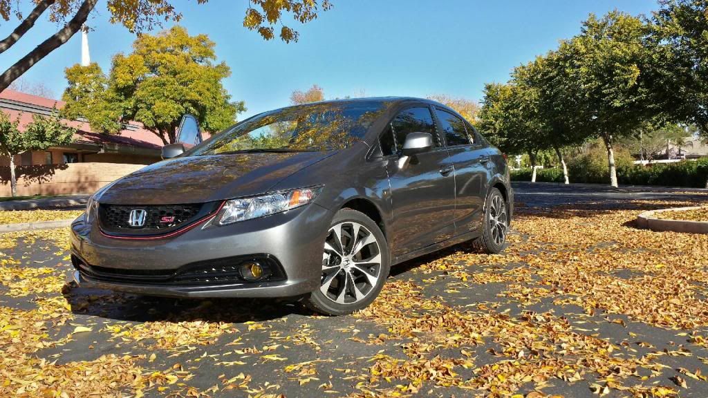

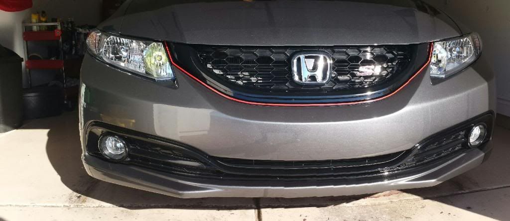

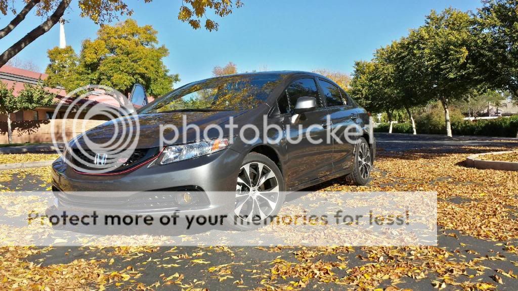

here is mine, i wrapped mine with gloss black vinyl, going to re-do it with "mirror-black vinyl" very soon:
Looks really good with the red stripe. Nice job.
