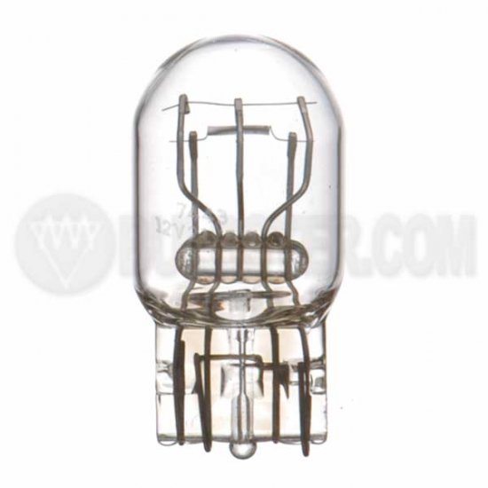

Mine would shut all the lights including headlights off when i turned my brights on. It would all just flicker then come back on. Thats when I took off my HIDs and it has still done it a couple of times. I'm not sure whats going on with mine.
May be totally off, but look at your front turn signal bulbs on each headlight. I had one turn bulb that went out and it did what you're describing. Replaced the bulb and the dash stuff worked again.

Bjorne was the one who mentioned it to me. Low and behold it was that. It was like the bulb was not 100% blown...and the wire in the bulb was touching every now and then shorting out

it was a front turn signal bulb. Two of the wires would randomly touch in the bulb, and it kept taking the interior lighting out.
I believe it was the 7440 bulb on the car, or something like pictured below. Only one had failed, and I didn't know it.
