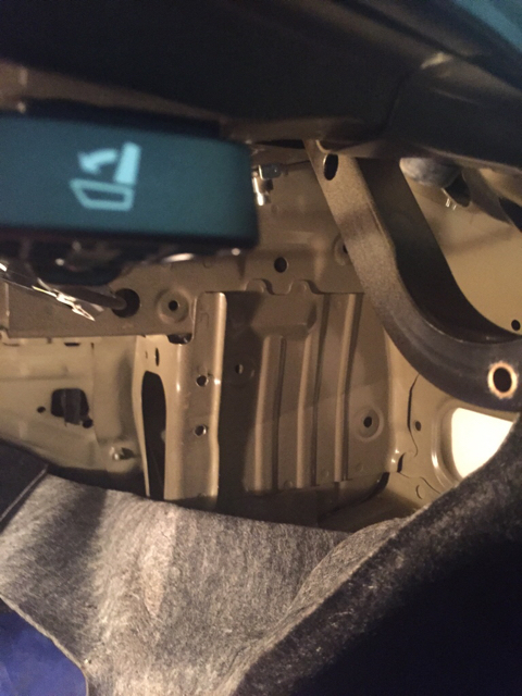

    I looked at using lift struts, but could not find them short enough for my liking, so I went this route.
    Found a good spot on the trunk wall to mount

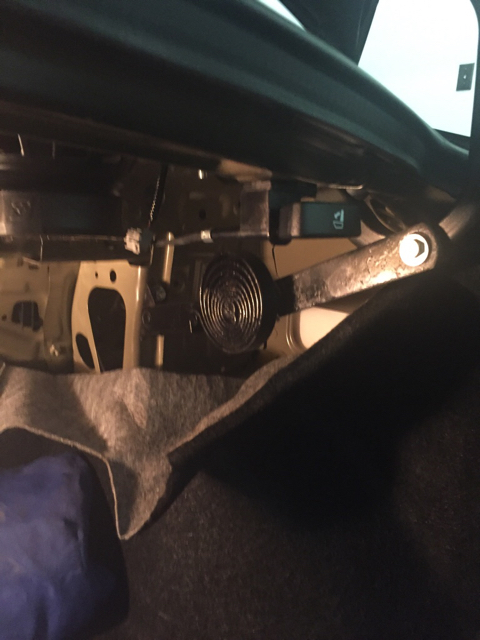

    Used a brass bushing in the hinge bar
    [​IMG]

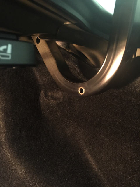

    Drilled and mounted
    [​IMG]

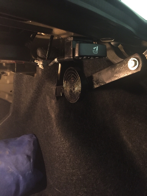

    Then cut carpet to complete, about a 45 min job
    [​IMG]
