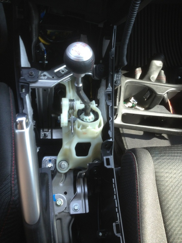

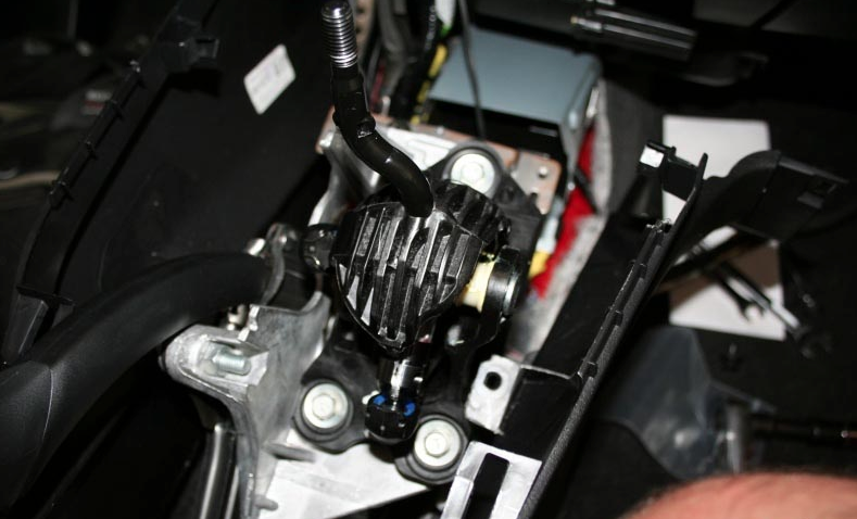

the part numbers are not the same as a 2011, but the only way to really know would be having the 2 side by side.
9th ^^
8th v v
^^ ahhh finally! Thanks webby

The bases for the shifter assemblies mount totally different. 8th uses 3 bolts 9th requires 4.
