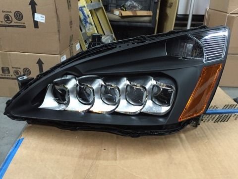

you should see some of the pictures ive gotten from my lights, its pretty much a frankensteined shell of an accord headlight assembled with patchwork plastic welded in from the mdx light. They arent a easy retro so whatever you can do to make them work for you is fine
