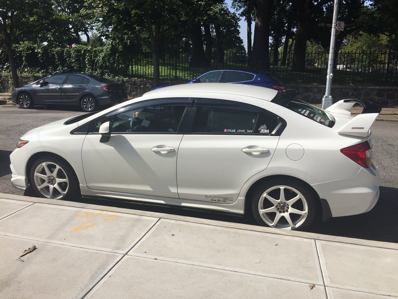

    I didn’t do much on the car except getting these below on Black Friday
    1. AVS aero skin hood protector
    2. Genuine JDM hazard switch
    Picture was taken before the holiday.
    Cheers
    [​IMG]
    ruddyrid, webby and bauer311 like this.

    The AVS hood protector is installed. The front end is now more aggressive. I’d say the fitment is 90%. I was trying my best to align both sides but it’s always one side slightly being off about 2mm. You cannot notice until you look at closeup. I got it on Black Friday sales for $40. I call it a day. [​IMG]
    ron v, webby, bauer311 and 1 other person like this.

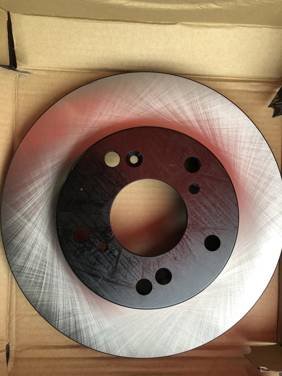

    The first thing I will do in 2019 is to replace the front brake rotor and brake pad. It’s been a month or two I’ve been hearing noises while driving. I know the rotor has been warped and the pad has been thin.
    I’m currently using Power Stop brake kit. Although I like the look of cross drilled and slotted rotor, I don’t think the braking power has improved.

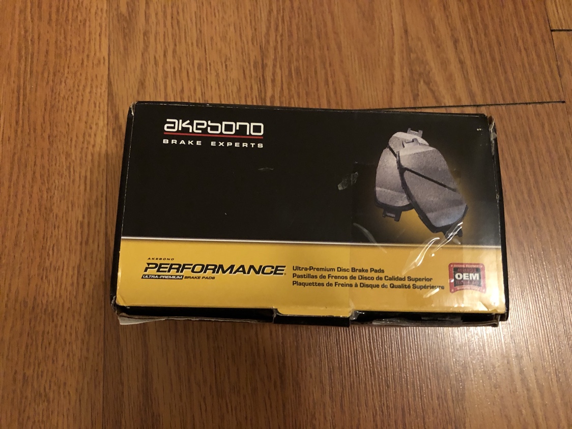

    I will be getting Centric premium blank with Akebono street performance pad this time. I’ve been hearing lots of good things about this combo. My car is daily with 40-50 miles per day.
    The second thing to do is alignment. It’s been overdue as well. Sometimes it’s pulling to one side. This also confirms if the noise is resolved as well. My friend and I suspect the noise is from the warped brake rotor itself, not from the suspension, end links or ball joint etc.

  17. Cman46290
    Cman46290 Active Member
    Messages:
    47
    Yeah a cross drilled and slotted rotor will most definitely not IMPROVE stopping power. Less surface area on the rotor will more than likely perform worse.
    As far as heat dissipation though, it will probably be harder for the rotor to warp due to ridding itself of heat a bit better.
    And they look cool. :)

  18. Tak
    Tak Well-Known Member
    Messages:
    599
    Location:
    New York City
    Vehicle Model:
    LX
    Body Style:
    Sedan (FB2)
    I like it being like look cool. However I’m tired of the warping and sneezing noise.
    I will invest on a quality slotted rotor from Stoptech on my next set. I’ve had the PowerStop’s brake kit for 2+ years and it’s been fine until few months ago. I swear this cheap quality cross drilled and slotted rotor ate the brake pad like crazy. It’s also rusting on the edge of the rotor fast. I guess I paid what I got.
    The Centric premium rotor and Akebono street performance pad are both arrived . I will put them on soon. I’ve researched about this combo and many people like it. Centric is also Stoptech. I should see some improvement than a cheap look cool rotor.
    Thanks
    Update:
    After changing the rotor and pad, I feel as it’s more firmer when I press the brake pedal. I didn’t have that “firm” feeling before. Time will tell me more.

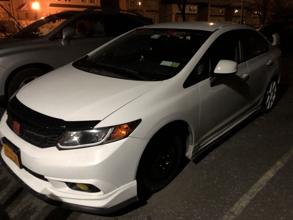

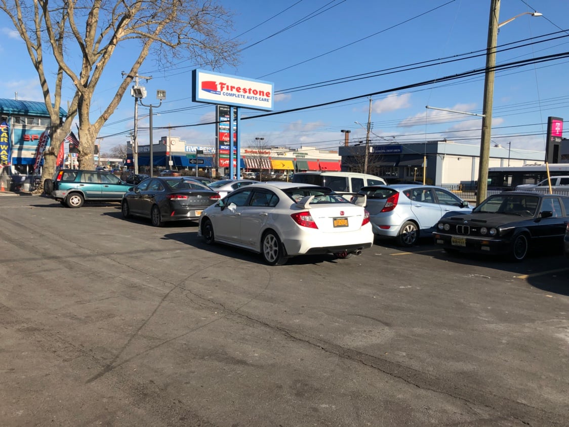

    The weather of NYC on Martin Luther King’s weekend dropped to single degree due to the snow storm. I drove out for grocery as normal. I thought I’ve hit a small pot hole or something on local streets. Then I heard. The tire pressure alert popped up right away. I checked the tires. The front tire was blown.
    Driving with a donut in the front was scary because civic is a FWD. I feel it’s losing traction.
    Next day I was hunting for the replacement tire I needed 215/45/R17. But none of the local tire shops got it or they only got some cheap unknown brand. Finally Firestone got my $. Front set is the Continental which is the one I’ve been running and rear set is on Bridgestone.
    What a terrible weekend.
    [​IMG][​IMG]
    Verzerrung likes this.
  20. webby
    • 2019 Toys For Tots
    webby Administrator
    Messages:
    50,694
    For future info, if you blow a front tire, you’re supposed to move a full size tire up front. Then put the donut on the rear.
    squiggy, bauer311, Tak and 1 other person like this.
