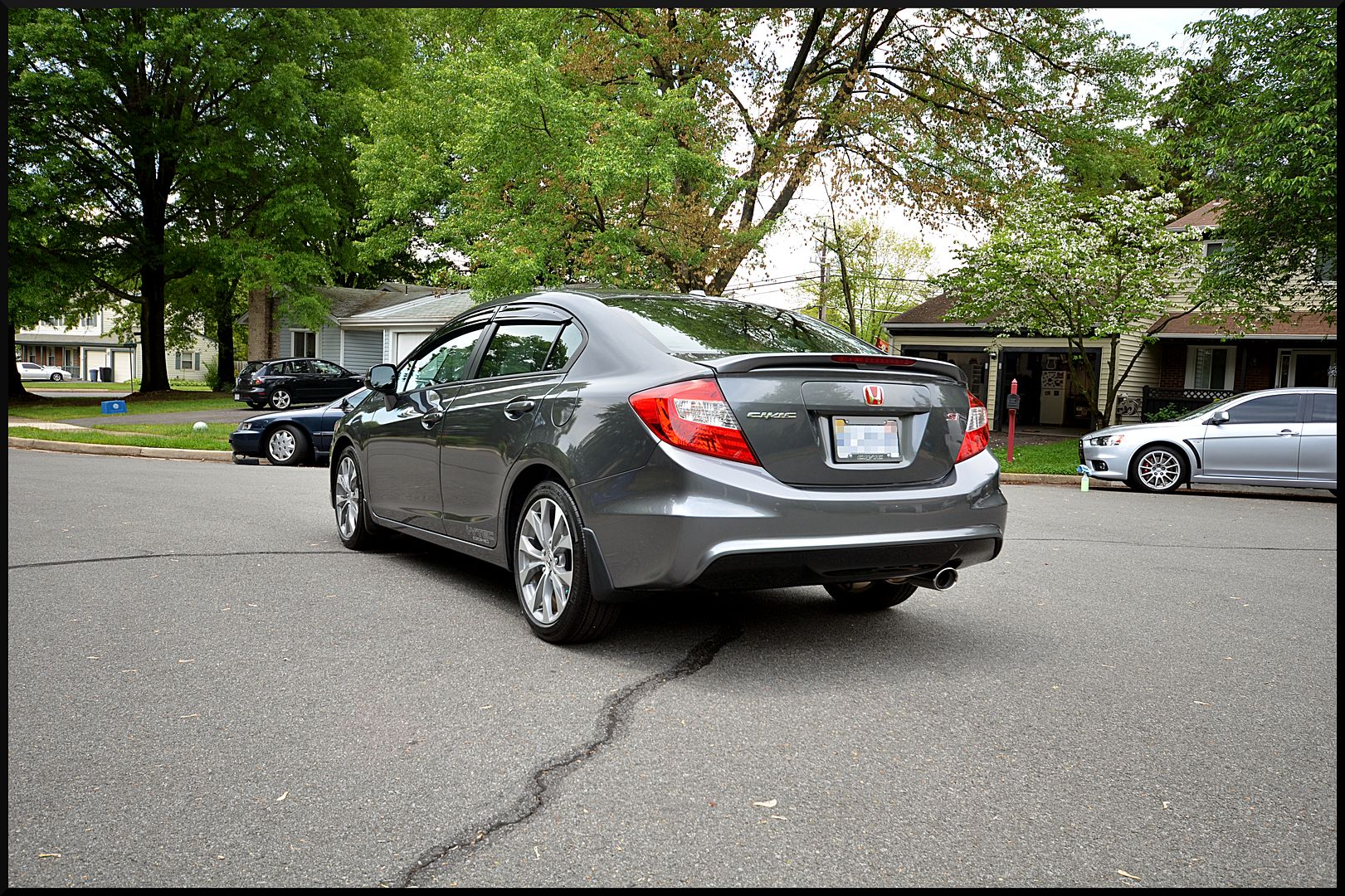

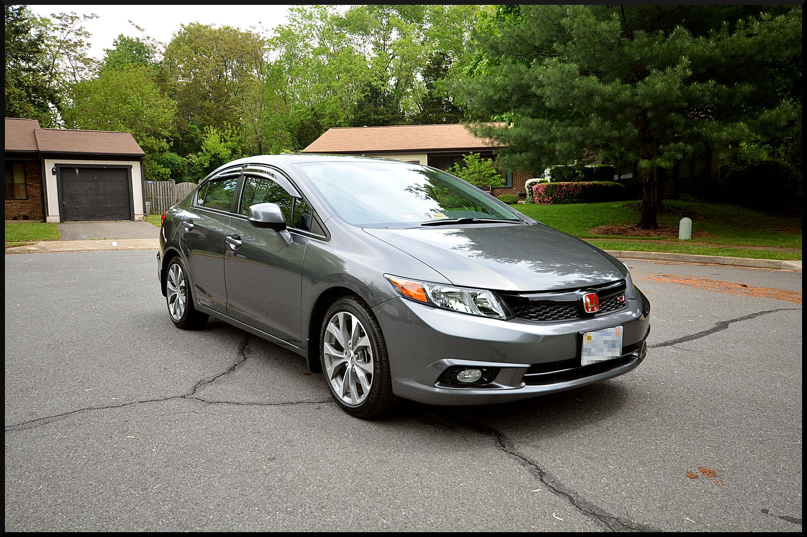

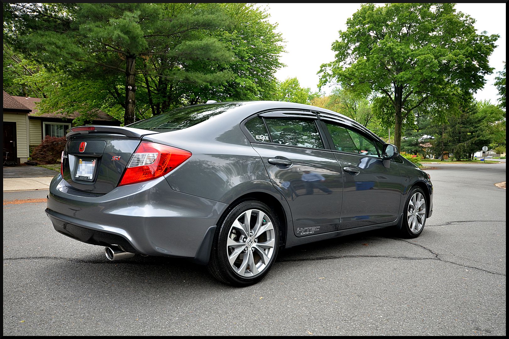

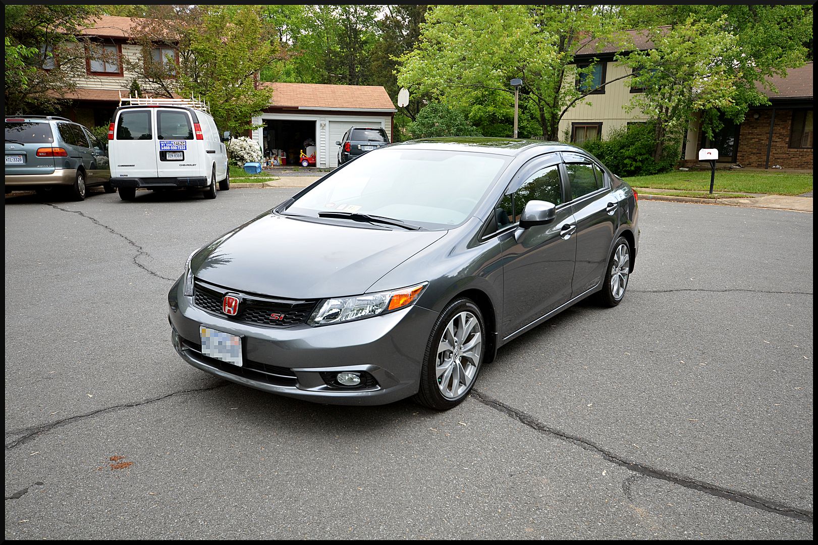

I had my long time friend, JasonAndre stop by the garage today to get his 2012 Si sedan polished out and coated with Cquartz Finest.
He showed up with his Polished Metallic 2012 Si Sedan that was in great shape, but was in need of a bit of TLC. We started by cleaning it all up with a rinseless wash, followed by a light claying to remove some surface contaminants. The paint was in good shape, so we went with a light polish, M205, to remove the light swirls that were present on the paint. The sun didn't cooperate with us until the very end of the detail, and the swirls were very light so we didn't get any before pics.
After the polishing we wiped the paint, glass, and trim down with Car Pro Eraser and then applied two thick coats of Car Pro Cquartz Finest for protection. This is a silica coating that comes with a 2 year warranty and will help prevent minor swirls as well as repel dirt and water much better than standard waxes. It also gives an amazing gloss to any paint. Here is how the car turned out.

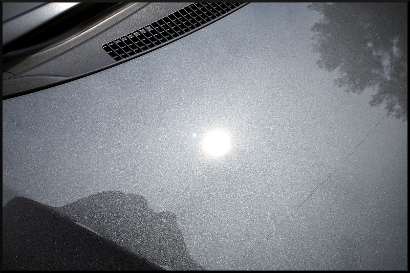

Here is the sun trying to peak out from behind the cloud to show the swirl free finish!
