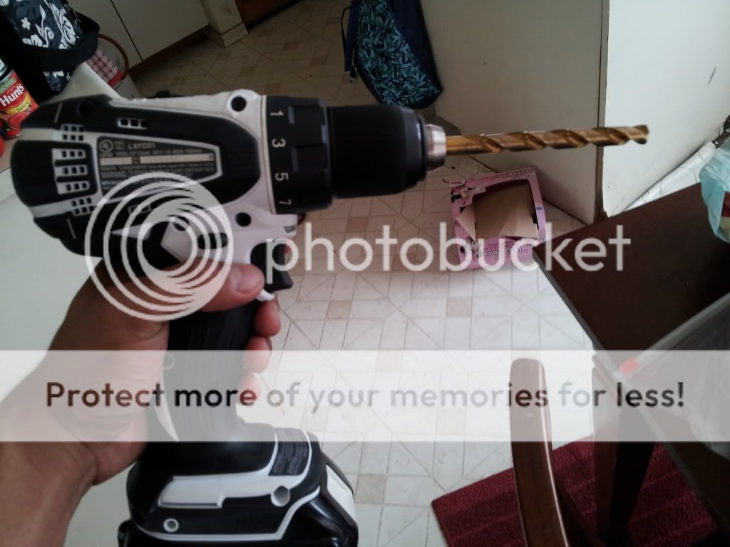

-drill gun w/drill bit

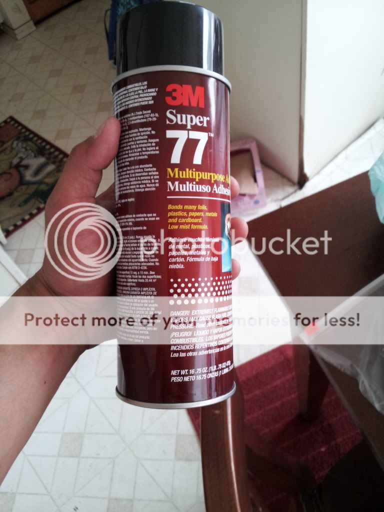

-3m spray adhesive

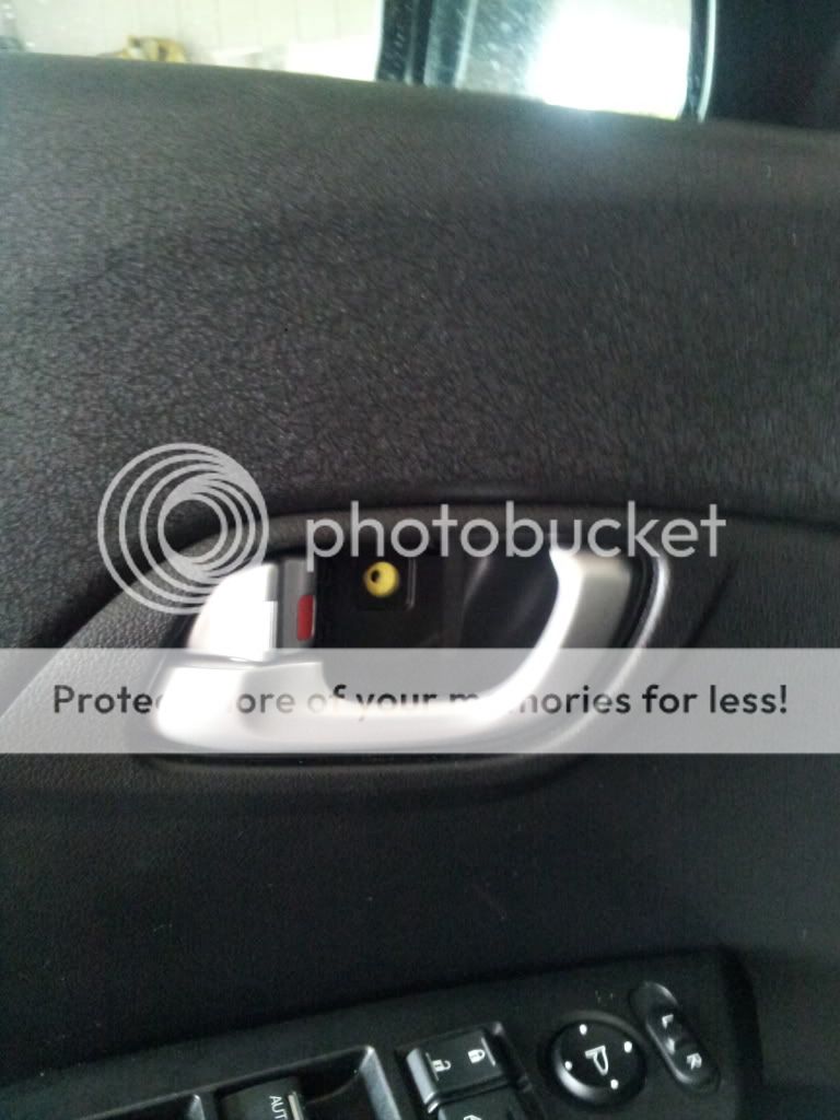

First you need to remove the cover that is in the door handle by pulling on it and pushing down the clip.
Unscrew screw.

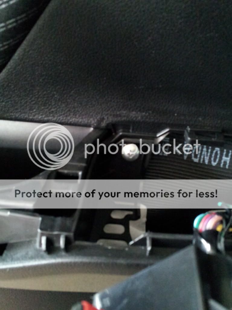

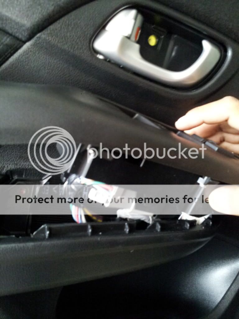

Next you can pop up and remove the door controls and also remove the relays that are attached
Unscrew screw
Then from here you can remove the door by pulling on and popping it from one side and working your way around

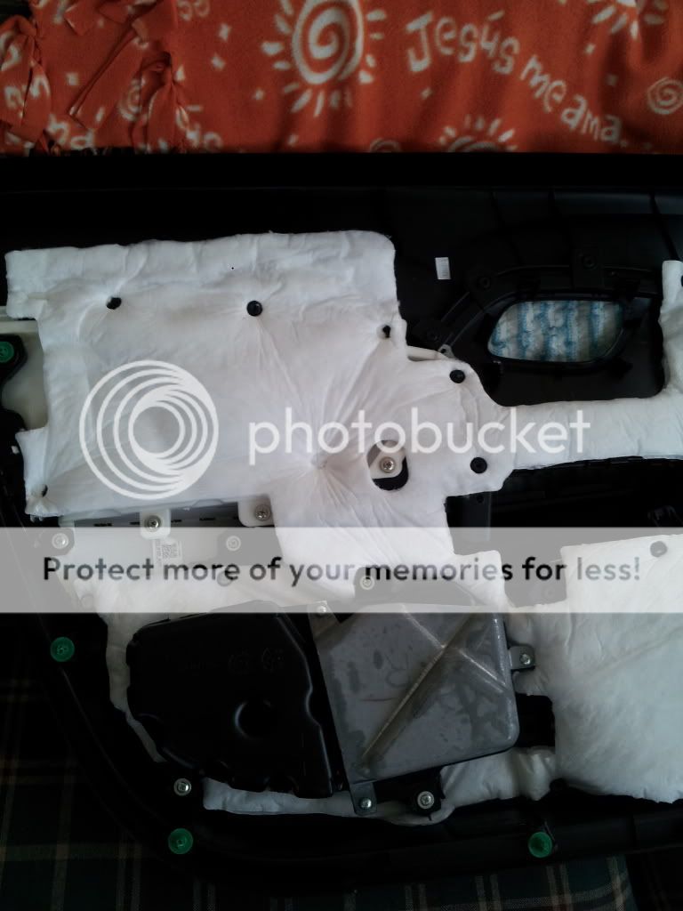

As you can see there's screws to unscrew also plastic tabs that you'll need to break. I used the drill gun and bit and found was the easiest way.
Their should be 5 screws and 4-5 plastic tabs to drill

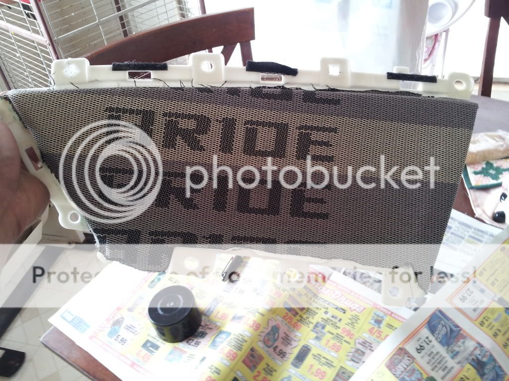

Pull out your door insert and remove the old fabric.

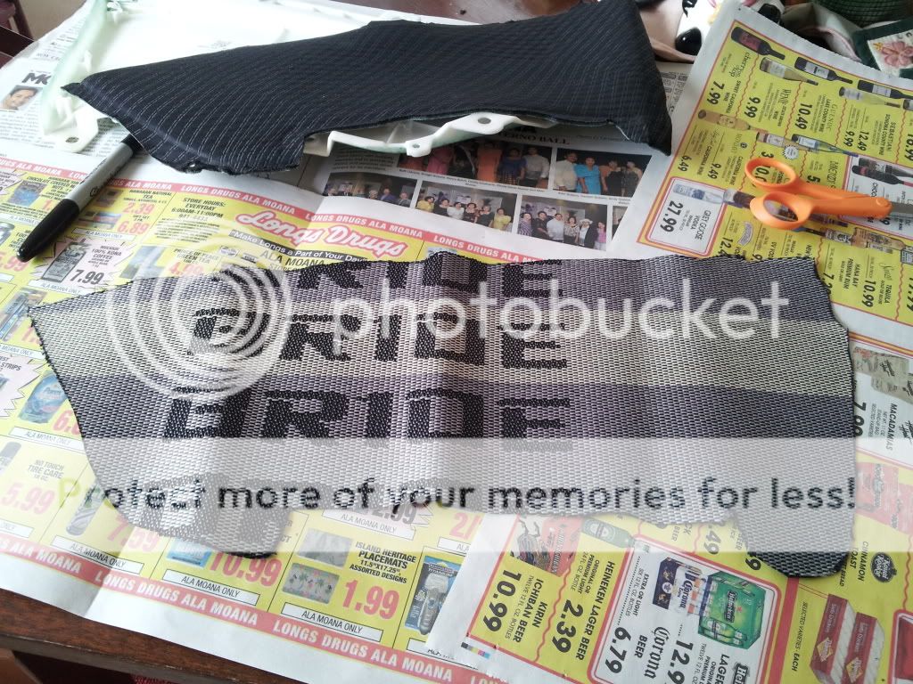

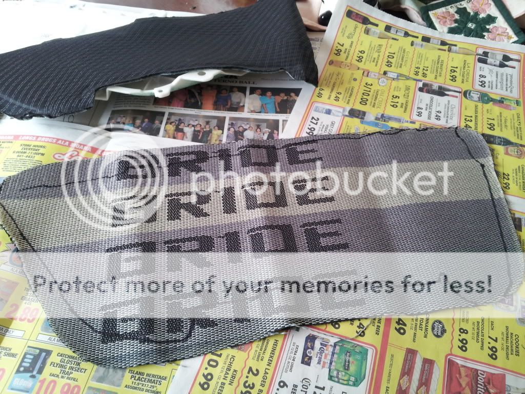

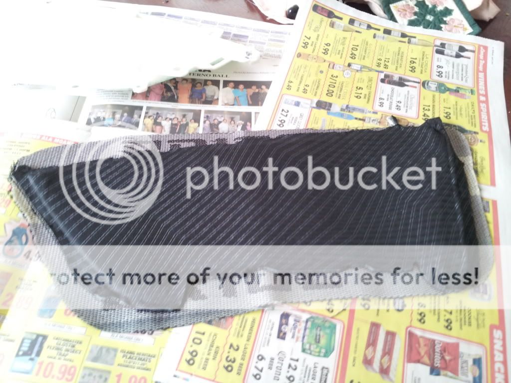

Then get your new fabric and if its not pre cut already then just trace your old fabric on your new one and cut out.
Make sure to test fit
Next spray the 3m adhesive on both the panel and new fabric and put it on while aligning it.
Then let dry for about 30 secs with using the 3m spray other applications may take longer.

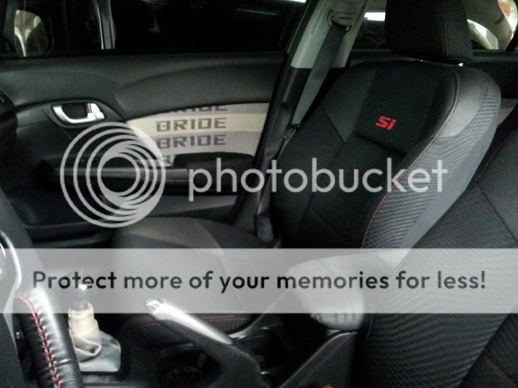

Then put everything back together the same way you took,everything off and that's it!
Repeat process for the other doors.
