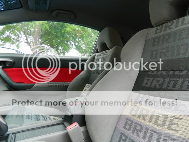

Yeah man these plastics scratch real easy. Should try it. I remember seeing a lot of the 8thgens doing this to their cars so I figure I try it out and I think it looks pretty good.

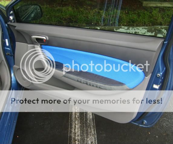

You can epoxy the tabs back on or I used small lathe screws. If you do us the screws be very careful. There's not much material there and you need to put them in by hand to ensure they don't go through the other side. I did it this way because I will probably need to go back in and change the material again. I used green which is not appealing to a large number of people. This way with the screws I won't keep destroying the plastic.

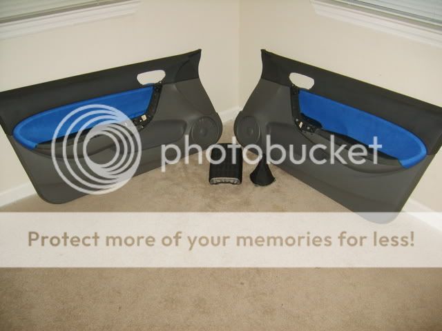

I would suggest headliner spray adhesive, I have done over 15 8th gens including mine and my friend's. I have used every kind of 3m spray adhesive and none of them hold well over time besides the headliner spray adhesive which is specially made to hold up to the heat. Here is a picture of my old r18 (the entire interior was done by me) and also the blue set I did for my friend, including door panels, center armrest and shift boot.
