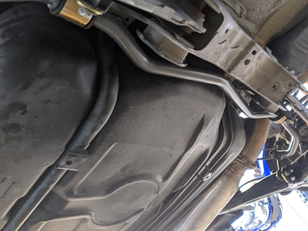

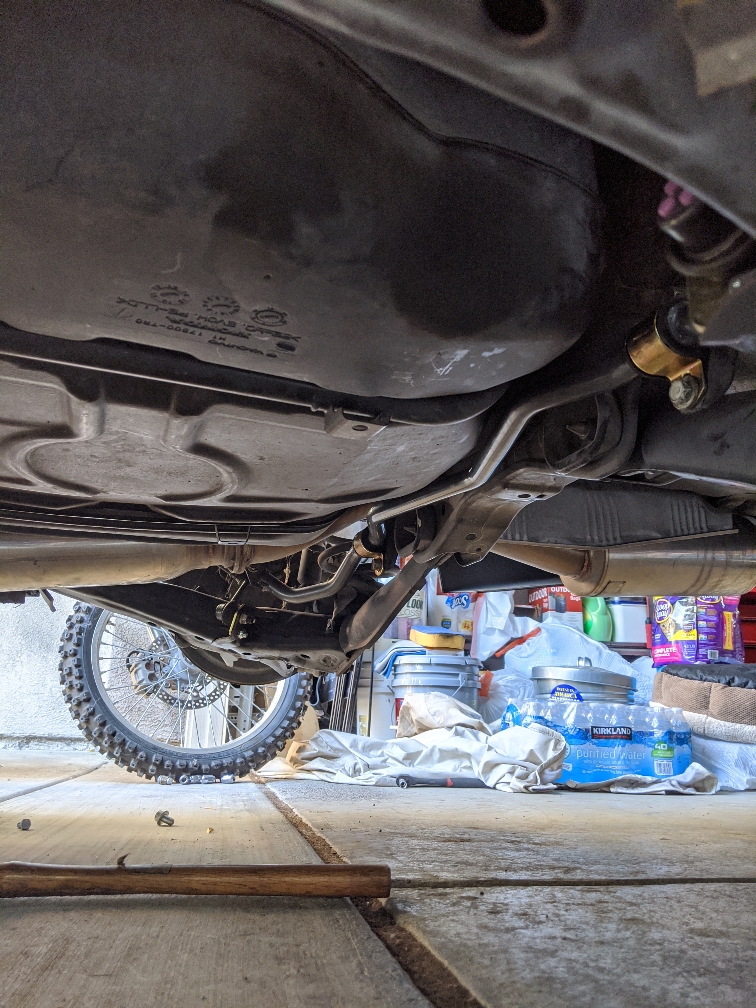

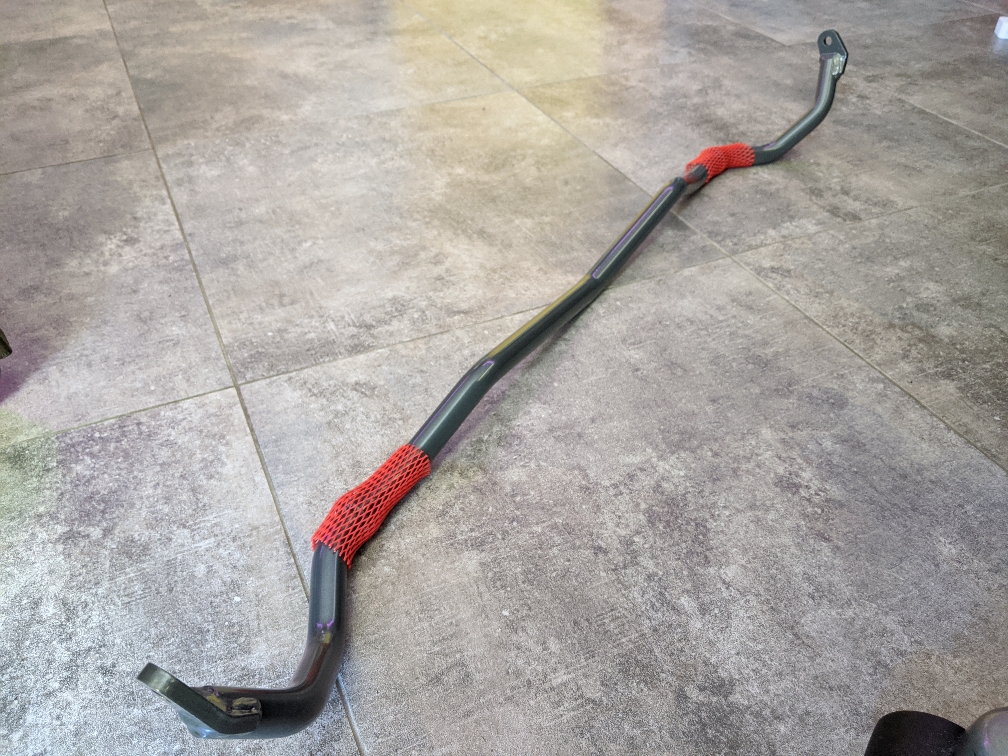

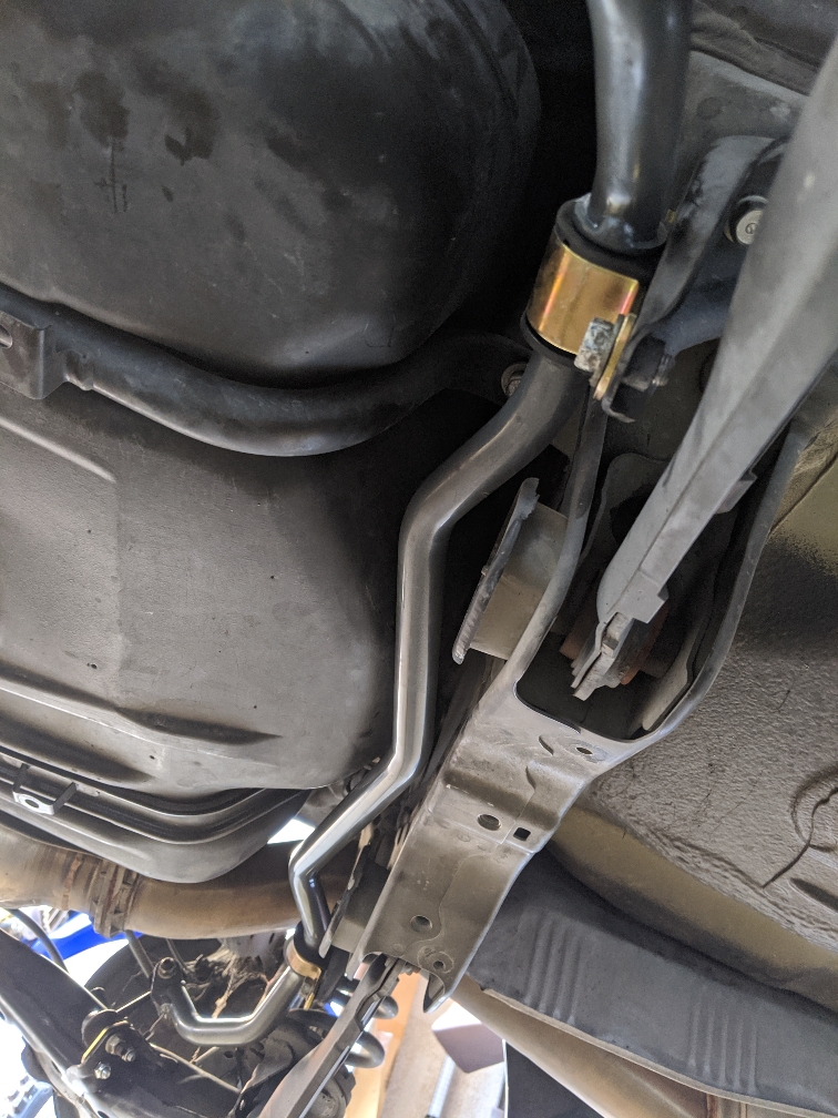

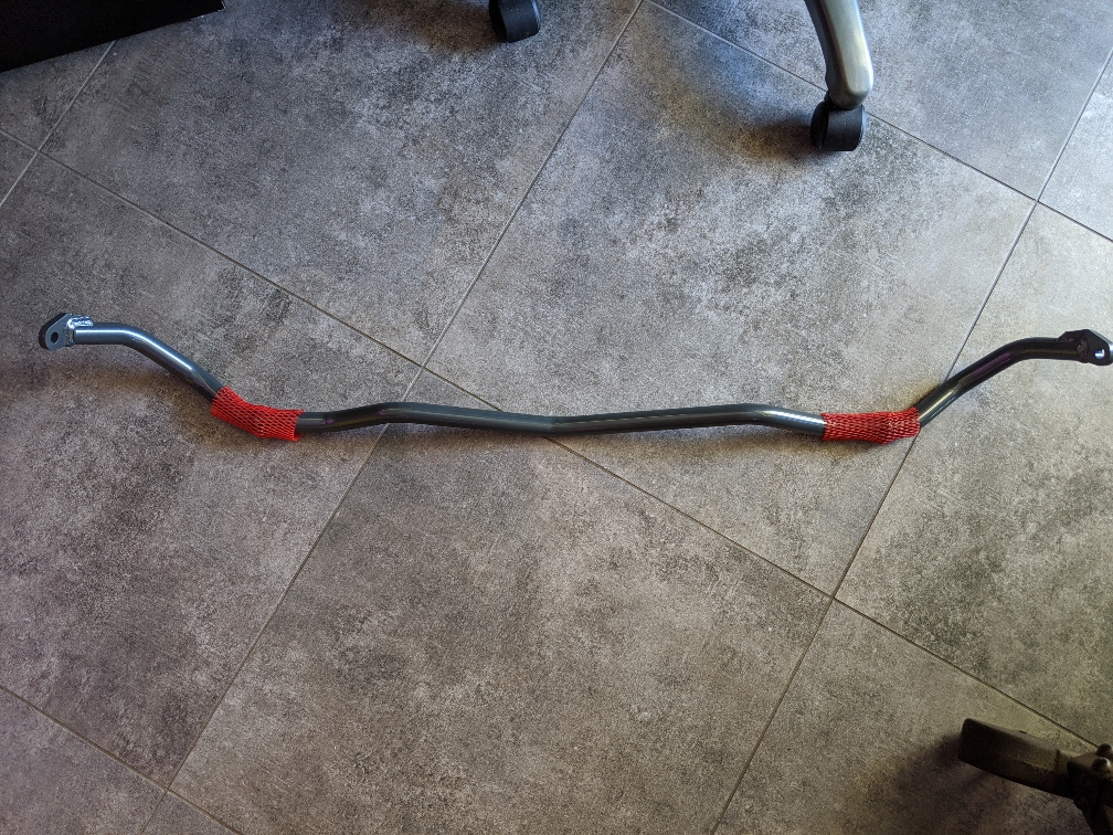

Progress 22mm Rear Sway Bar installed with @ron v.
Only did about 15 miles, but hot damn it handles so much better. I'm glad that the RSB was installed prior to any other suspension upgrades. Being able to tell the difference with just the one upgrade was AWESOME. People say that this upgrade is one of the most bang for your buck upgrades and I'd be hard pressed to disagree.
Sent from my Pixel 3 using Tapatalk
Energy suspension bushings and moog end links make the 22mm solid progressive sway bar work even better. The bushing that come with the sway bar are not as good as well as the stock end links. I have to agree, 22mm progressive actually turn the car into a sports car. I would say the hasport engine mounts and this sway bar are the two best things to add. It takes grease for the bar to slide better and work better too. I just got the acuity shifter collar fixed too-change the tranny oil too-very easy now with a acuity CAI intake. Add the tranny fluid from the top 2 qts exactly after draining fluid. cnt catted down pipe $289 and its 3" working fine
