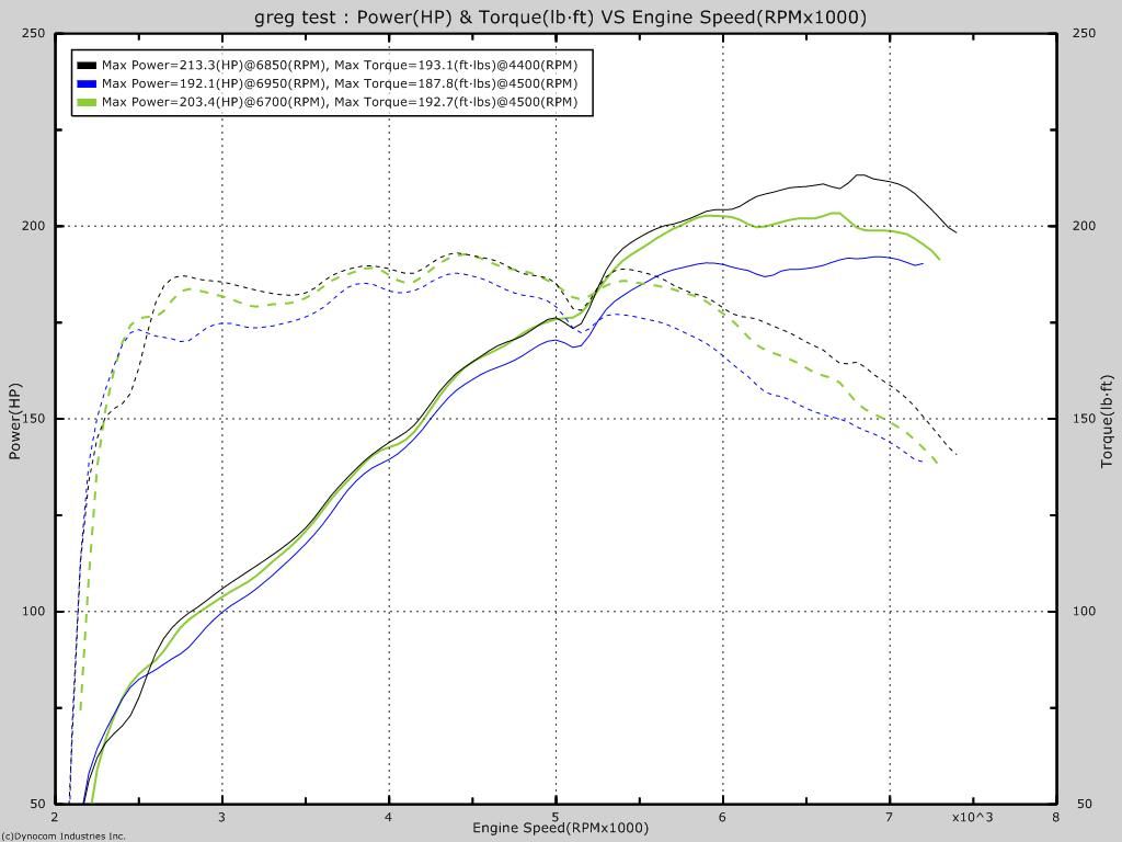

I am pretty new to this site, but I've been very active on other Honda / Lexus car forums for over a decade. After many, many prototypes, I'm almost finished with a new mid-pipe with integrated HFC for the '12+ Civic Si, and just can't wait to share the results any longer! Below are the dyno pulls from the same car on the same dyno (DynoCom) on different days using SAE correction.
Blue is totally stock (totally)
Green is totally stock except for my mid-pipe (stock tune)
Black is totally stock except for my mid-pipe and custom tune
Note that this is with the stock muffler! The car sounds totally stock, so it's definitely a "sleeper"
Mods ... I have every intention to become a sponsor ...
