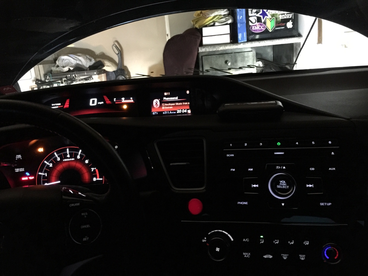

Also, is anyone else's hazard super dim? Either the pictures I've seen make it look brighter than it is, or mine isn't very bright.
He's right in a sense. It's crooked so it's not a 100% right. Installed yes but not a proper fit.Hazard installed on my '13 coupe. Bought it from a dude that insisted there was absolutely no way to install it on a '13 Si.
He must not have tried swapping the brackets.

Where did you get that sticker? The triangle is gonna bother me being offset lolTweaked mine up a lil. Bought a 2012 hazard button and it is slightly angled in my 2013 Si. So..I did this
