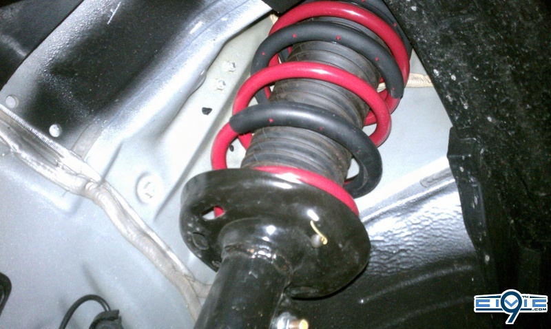

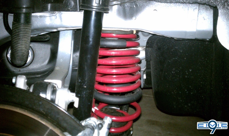

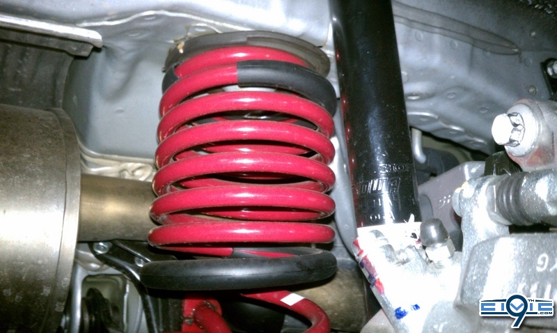

2012 Civic Eibach Sports-Plus Springs & Antil Roll Kit Sway Bars (Front: 2 inches drop and Back: 1 and 3/4 drop )

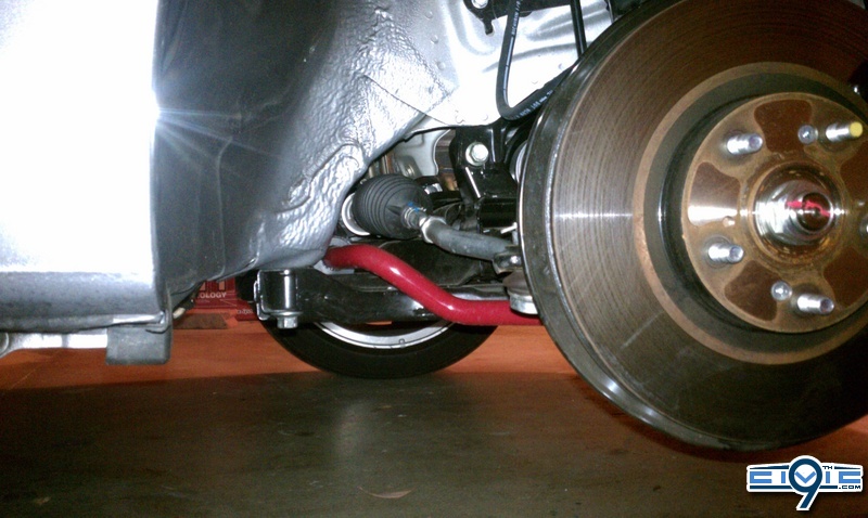

You can barely see this, but this is the Front Sway Bar:
Front Sway Bar:
Pictures by Mikey6p:
****Update 7-6-2012*****
It has been more than a month now that I've been driving with The Eibach Sportline Spring and Anti Roll kit. In my opinion, the handling is better; I was pretty surprised of how smooth my ride is now, very similar to stock not harsh or bumpy at all; however it all depends on the road condition though. There is no added noise at cruising or fast speed. The overall drop is 1.8 inches for the front and back (This was confirmed with Eibach). I also have the rear upper camber kit.
The Sway bars is a plus, I have a 24mm Adjustable Front Sway Bar and a 19mm Adjustable Rear Sway Bar. I can totally feel the difference especially on sharp turns, my car just hugs the road nicely with no problem, no shaking at all, just a firm handling.
Overall,I am pleased with the ride smoothness with the lowered look, and it has me enjoying walking out to my car and looking at it from afar.

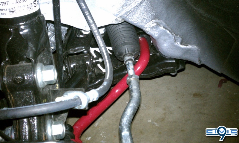

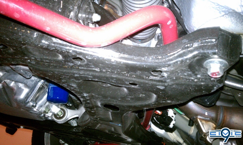

looks like the front subframe has to be dropped to install the sway. or can you thread it through without unbolting the subframe?
Looks pretty damn sharp. Bet it handles even better.
Also, that first picture is the front sway bar, not the rear.

wow. looks great. did you need to drop the sub frame to get the sway bar in?
