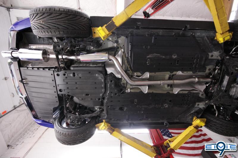

some pic's i took with phone. will take more this weekend .
came with everything to install
the flange to the converter needed a little help had to oval out 2 holes and knock out one
the guy who put it on said they used a unversal flange.
had to cut off about 3/4 inch to mate the pipes
looks good... so one piece was slightly too long?
i have a sedan there are 3pcs. plus clamps.
the coupe has a diffrent set of pipes.
the first pipe about 2 foot long goes from the flange at the cat and slides into the next pipe that has the resonator on it .
then the resonator has a flange that goes to the muffler.
the pipe that slides into the other pipe had to be cut 3/4 inch
the guy who put it on said its a normal thing ,better to have it too long than short.
