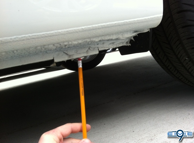

None of that feels more than 1/4'' thick, but if you guys say it would hold the weight that works for me. Except for the paint issue...
If you use the jack that came with the car it will fit right on the ridge , if you use a flat head jack I'd go about 6" s further under the car pass the ridge till you see a sunken place that it will fit on.
I will check to see if there is a space wide enough that far in that will accommodate a floor jack. Thanks!
I don't have a 2012 to snap pics, but I could go to a dealership and snap pics if no one else posts some up

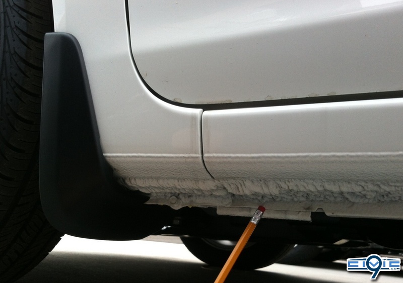

both the front and rear on the 9th gen have a spot that's lower than the rest. That is the jack point.
rear point on coupe -
front spot below -
as for the paint - I was notified at the dealership that they are all coated from the factory with an undercoating/weatherproofing material on the edge like that. You can see that line on both pics, and how it wraps under the car on the frame rail. They're all that way.
Thanks for the info! You guys definitely go out of your way to help a person out. I will now be doing the rears next weekend. Can't wait either as the fronts look great.
