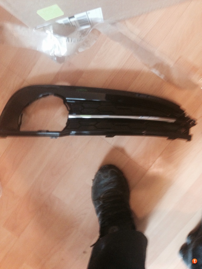

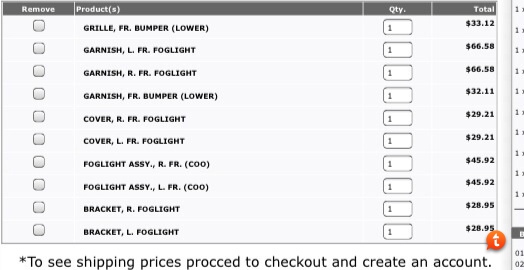

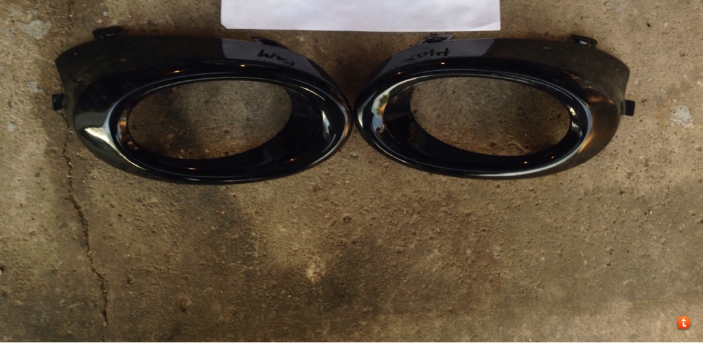

Do you mind telling me what parts you ordered? I'm assuming both fog light covers and garnishes and I see a front lower bumper garnish. Is there anything else?

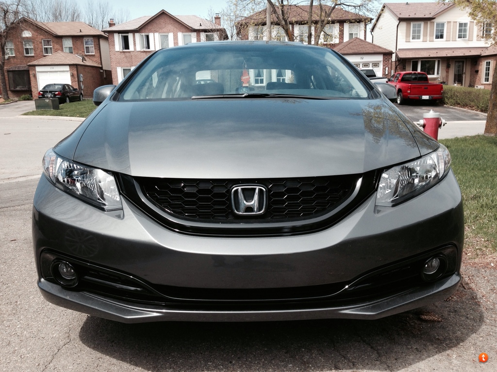

Pauly it's cause it is. Lol. Its the FD2 RR mugen bumper. Replicated for the 9th sedan. They did one for the 8th coupe and usdm 8th sedan . They'll all be replicas. RR Was for the FD2 sedan only and really rare not even sure if u can buy them unless u own a RR . .

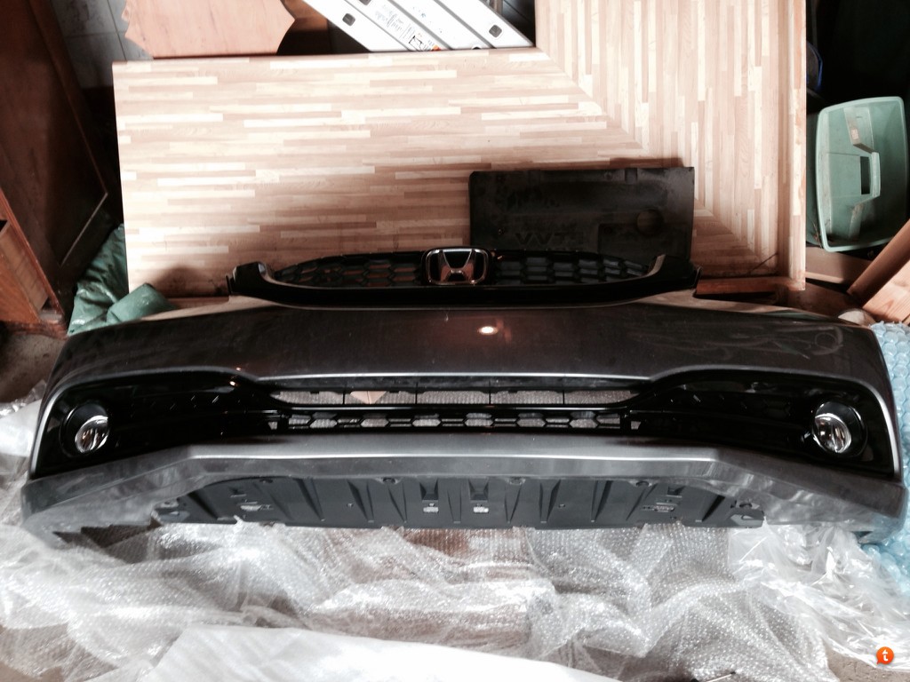

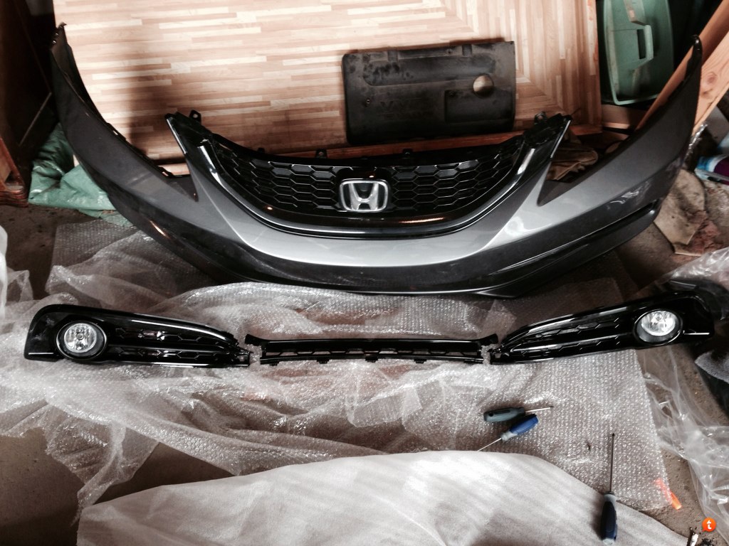

Okay I just bought all of the parts you recommended and the body shop bought the sedan is bumper already. So the only question I have left is when I'm ready to hook up the fog lights, are all of the fog light kits honda sells the same harness wise? Since I'm going from a coupe lx front to a si sedan front, could I use the fog kit from the coupe to hook everything up or should I use the sedan kit? I don't want to go through the hassle of making my own harness if I don't have to but if it's easier to, it's not out of the question.

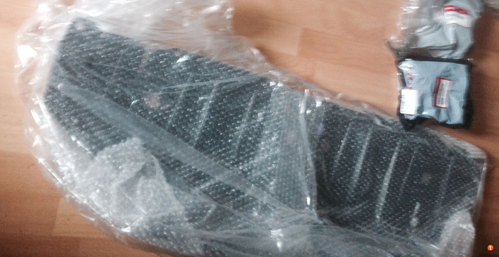

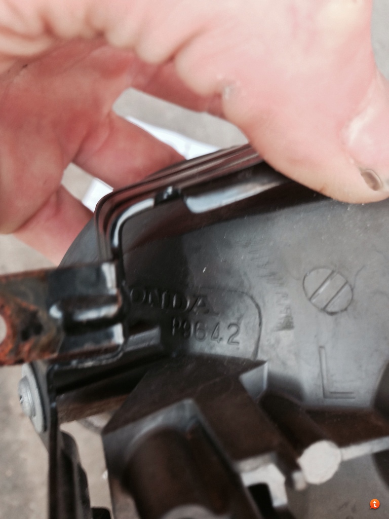

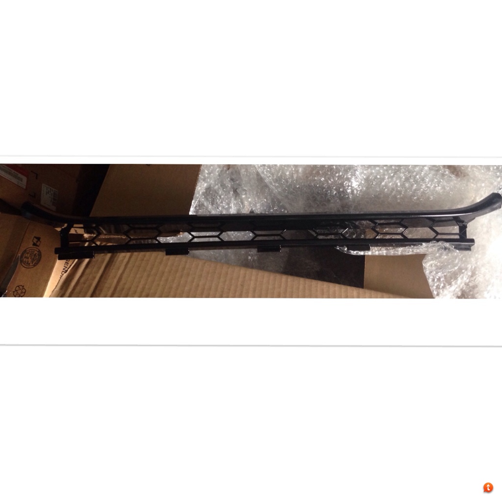

. Never got a good pic but the black plastic thing under the bumper also needs to be bought the EX-L one is different and the si grille garnish won't clip on![]()
