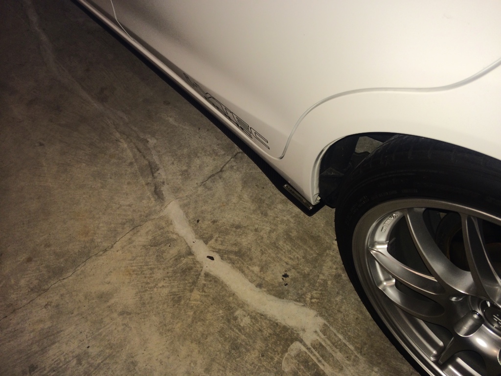

Betty White tying da twisties like skrewlaces Wit dat possible *Whine* on teh Side... bout dat lyfe.
