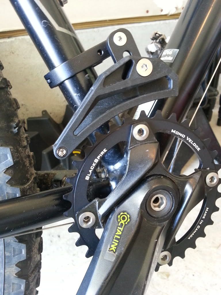

I decided a while back to make my MTB a 1x9 as I never use the lower or high chainring. I wanted to do this as cheap as possible because the MTB gets no money thrown at it. It's there for a workout tool only.
Origin8 UL chain guide
Blackspire MonoVeloce chain ring
