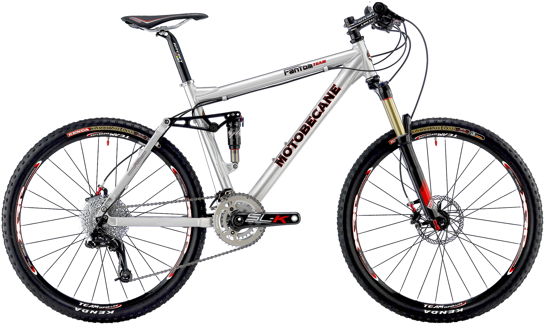

Yeah I've seen their stuff. It's generally spec'd out well with parts but the frames are iffy. Very cheap bikes though for what you get. I think they take factory seconds from major bike companies that don't pass QC and slap their own paint and stickers on them. I've seen a few in the repair lineup when I worked at a shop and you could see the frame designs and drillings for things like water bottle mounts in the same places as Giant, Fuji, Trek, and Iron Horse.
There are only a couple of major aluminum plants that make parts and frames for everyone in the bike industry so it's not surprising to see such similarities. However, the motobecanes had a variety of design and mounting variations leading me to believe that they get cast off frames. I saw one of their older full suspension bikes that had a bottom bracket that was welded on a couple degrees crooked. The guy constantly had chain issues but wouldn't believe that the frame wasn't straight since he had paid "OVER $500" for it. It was visibly crooked. Since it was aluminum there was no frame straightening option. If it was steel, we could have put it in the rack and bent it back to "good enough."
They may have changed in the last few years and are able to keep the prices low by selling directly to the customer and not to the traditional importer/distributor/bike shop routes. Similar to Tesla. It does make it hard to go test ride one though.

I was talking to a buddy (from my BF4 gaming community) who lives out in California that is over 60 years old and bikes quite a bit. He personally owns a Specialized Bike (I showed him all yours). He told me about a few bike websites (http://www.jensonusa.com/ and I believe the other was http://www.bikesdirect.com/products/mountain_bikes.htm). The bikesdirect website was where he told me about Motobecane. It does look like it has good parts but I don't want to worry about the frame. Like you said they could have changed but the models I was looking at on Bikes Direct was a 2011 model and 2012 model I believe..

Indeed. However, they won't do anything if it's bent or welded wrong from the factory. Well, less reputable companies anyway. Not trying to say anything bad about motobecane but I think for the money you are willing to spend I bet you could find a better bike locally that you can actually put your butt on. Buying from a shop also means you have a place to go back to for help and warranty stuff if you need it.
