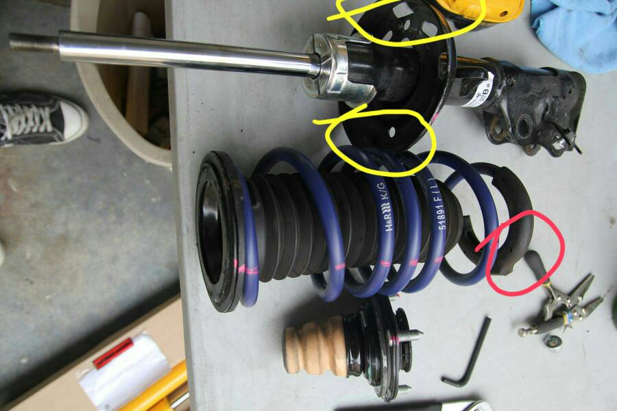

Found a perfect picture to describe what I'm seeing here. The red circle is the squarish part of the isolator and there is a little nipple that sticks down. The yellow circles are the 2 holes it can sit in. A cutout on one side that fits the square and an indentation on the other side that fits it. Still no issues but I'm worried if it will affect alignment or long term issues. What do you guys think? Any Honda techs on the forum that could be tagged?
Also the springs in the picture are aftermarket. The stock springs are evenly wound and not progressive, so same spring rate top to bottom
