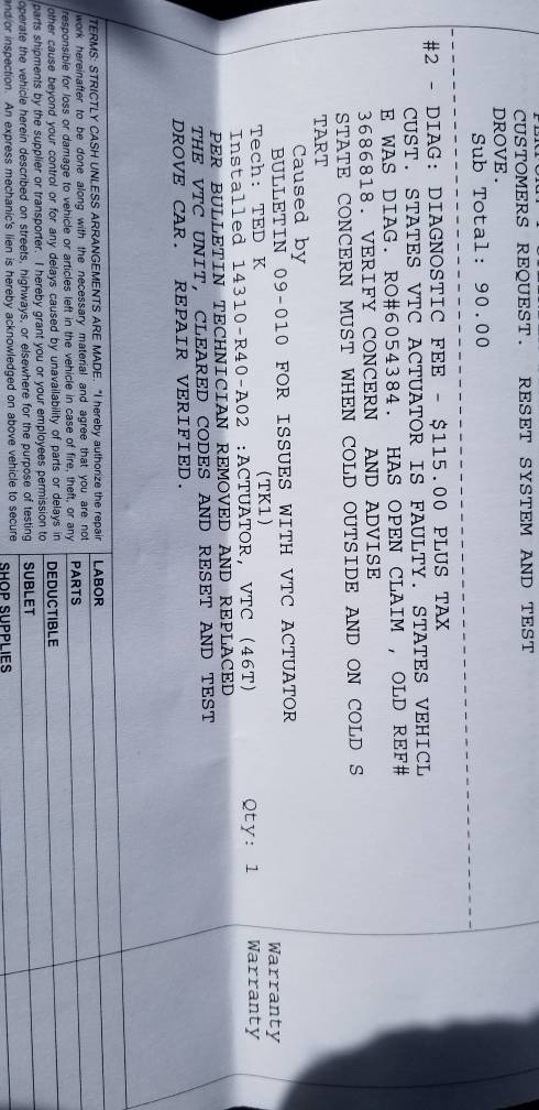

Last week I dropped my car off back at the dealership where I bought it. Honda honored my previous claim and replaced the VTC Actuator with the new (not so) recently released part.
The ordeal was as painless as possible, despite the deslership's best efforts to introduce human error at every turn. I made the appointment at the request of Honda Corporate and was told the Regional Parts and Service manager as well as the dealership Service Manager would be taking care of this and have everything under control. However, when I called ahead of the service appointment to make sure parts had been ordered and that there would be a rental for me to take (I live 1.5 hours from the dealership now) my entire case was a mystery - lucky I called ahead. Then once I got there it was a repeat, no one knew what was going on and i had to spend an hour explaining to an advisor what was happening. On top of that, they had never cleaned the rental they set aside for me so I got a different, dirtier rental. It even came with a free sock in the center console that someone had used to soak up some kind of exploded juice.
I got my car back Monday night and all is well in the end. The increasing slack in the motor and whirring chain noise is gone, and it has not suffered any grinding on cold starts; fingers crossed, that problem is gone for good. I was able to see the service order being sent back to Honda, and it looks like they did almost $600 of work under warranty.

Based on the work order I saw, they billed Honda for only 2.5 hours of labor, so it must not be that hard to do. I thought they would have to drop the motor out to get to everything, but it sounds like they were able to do everything from the top.

I got my 2013 Civic Si Coupe CPO in Sept 2018, and beginning winter (Ohio) started hearing the cold start rattle. At first, I ignored it even after going through the forums as it wasn't happening all the time. Then around March, I decided to get it fixed as the car is still under warranty.
Went to the local dealer, they seemed to know about the issue and responded positively, but had to replicate the issue for their tech before doing any work. So they kept my car and after a couple of failed attempts to replicate (it was getting warmer), they finally heard it and replaced the VTC actuator.
Since the replacement, I haven't heard anything but it is warmer now, so the only thing I can do is to wait till next winter to confirm whether it has been fixed for good or not.
Edit: Variable Timing Control, VTC Actuator - Replace S/B: 09-010
14310 - R40-A02 Actuator, VTC (46T)
12341-R40-A00 Gasket, Head Cover
