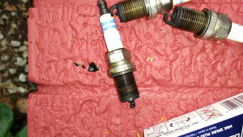

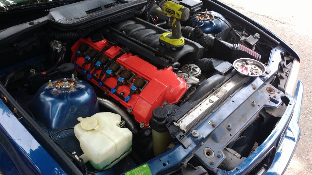

I changed the spark plugs.
I also noticed oil on the old plugs. Oil is seeping through the spark plug o ring gaskets. So I ordered a valve cover gasket.

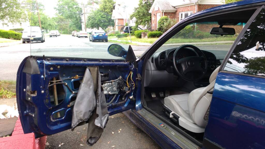

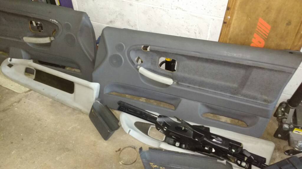

I also stripped the doors down since the door panels are falling apart.

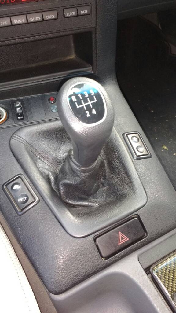

This $15 shift knob came in today. It looks good and very factory looking.

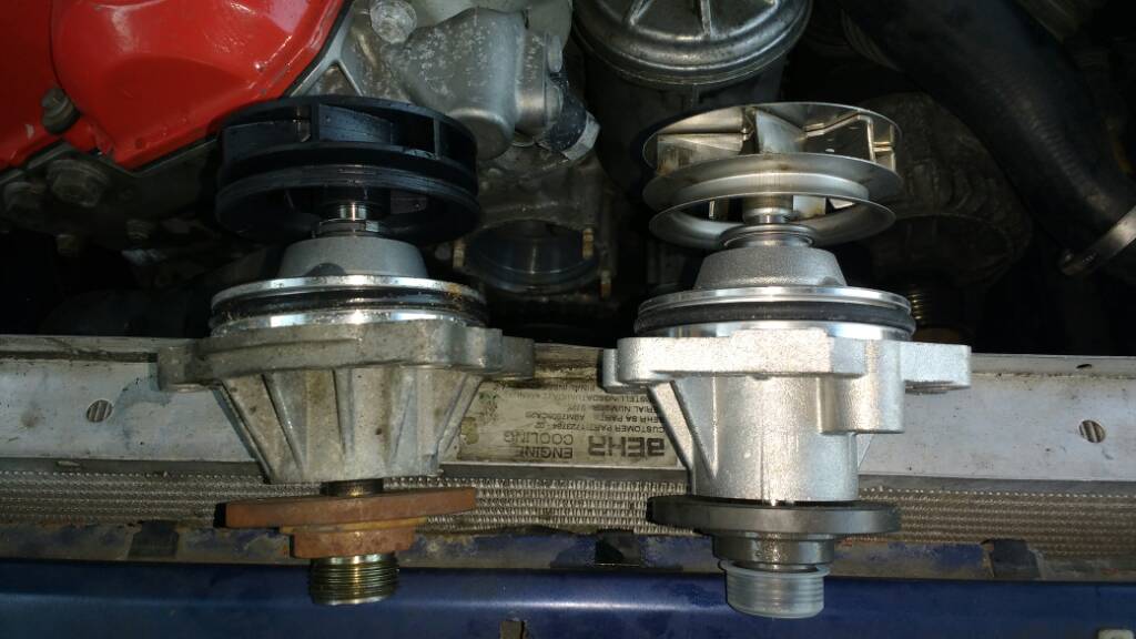

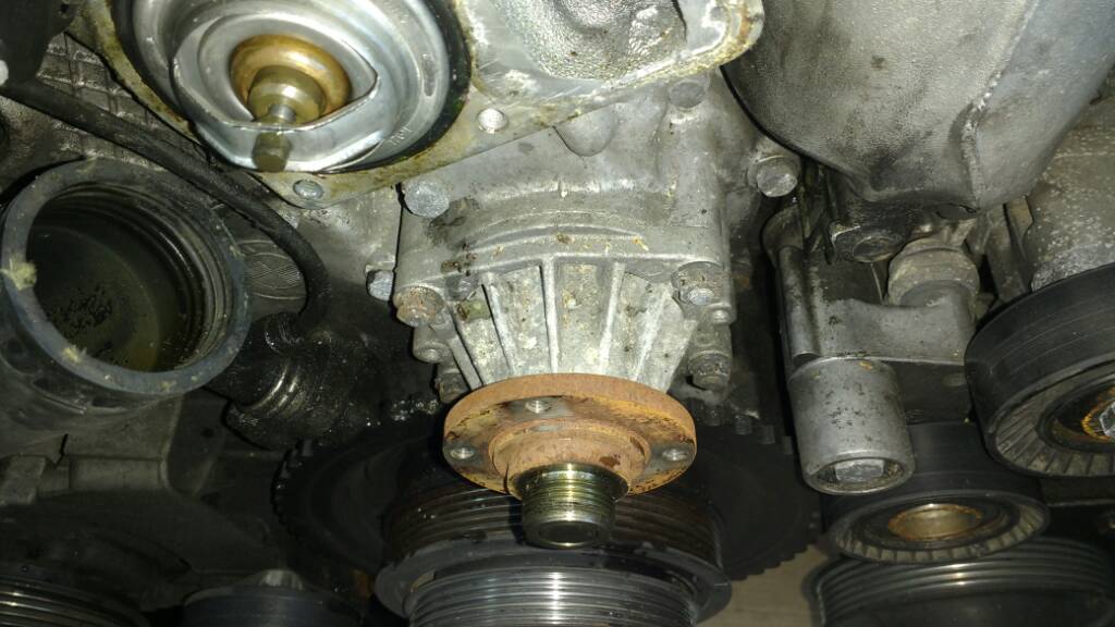

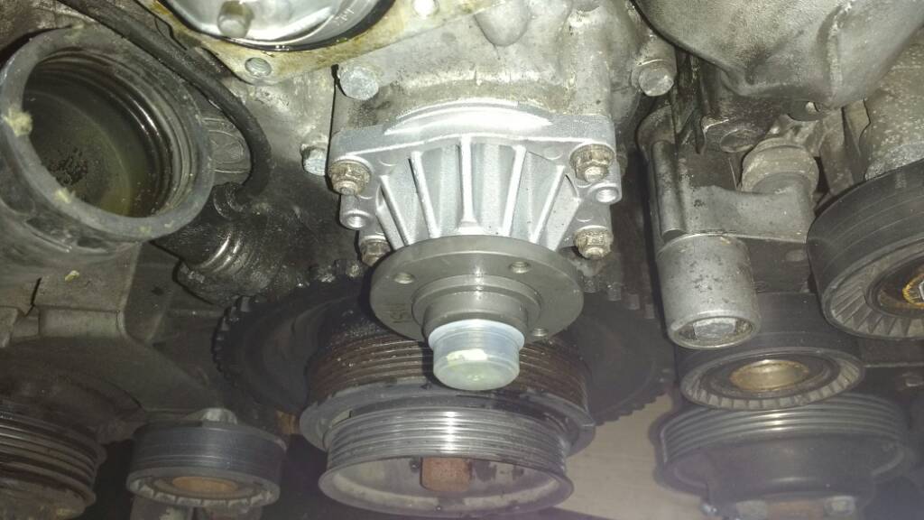

I also changed the water pump.
The factory water pump has a composite impeller that can get worn out and break causing it to not spin.

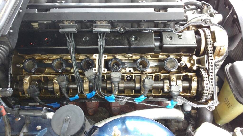

I had time to work on replacing the valve cover gasket. Two studs broke so I'll have to replay those.
The camshaft looks to be in a great shape for a motor with 171k miles.

Are you going to get rid of the red color in the valve cover?
Yep. Since there are two broken studs, I'll have to take the valve cover out again. Im planning on painting it a wrinkle black color. The person who did the paint job did a terrible job. The paint is flaking off.
