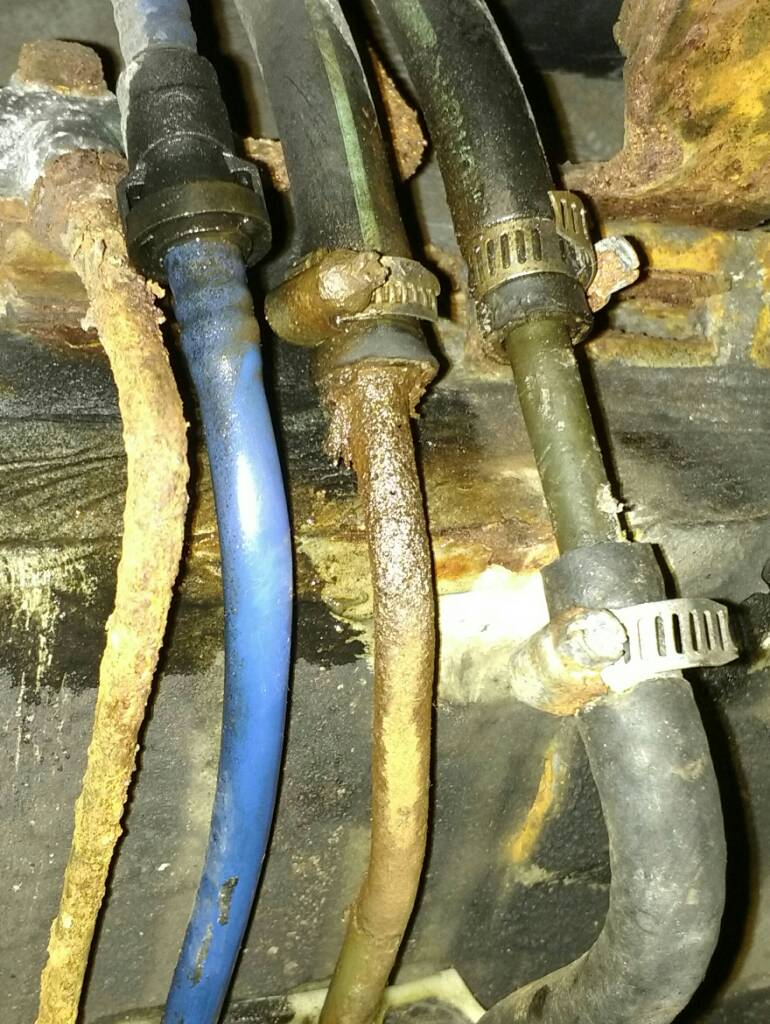

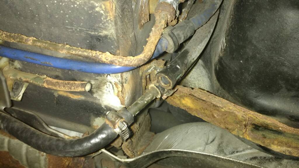

I also bought a can of POR15. I noticed some parts of the frame that needs some anti-rust coats.

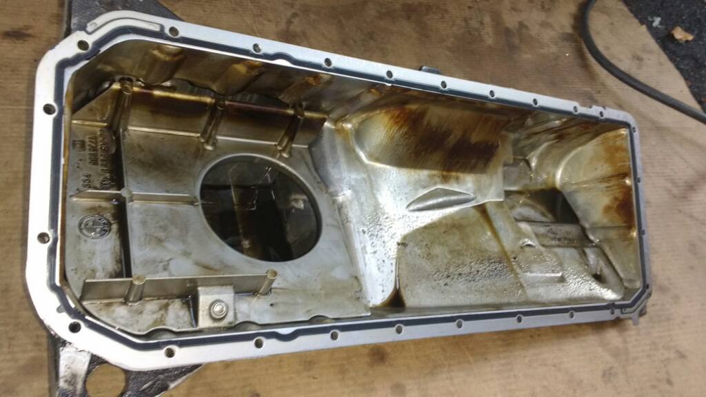

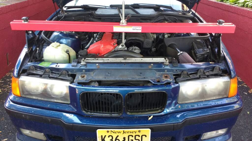

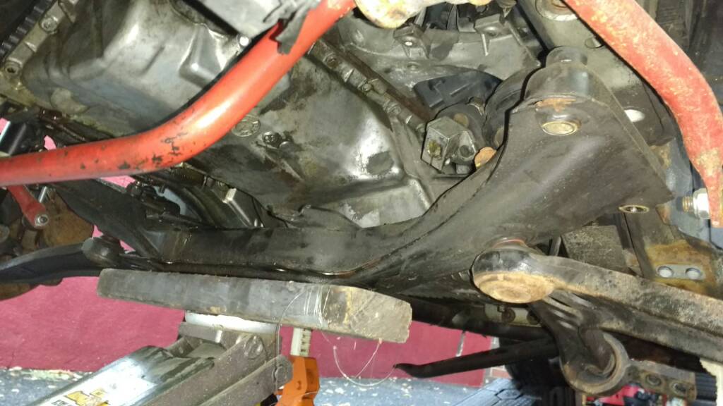

Oil pan removal. Part two:
This engine support from harbor freight is pretty good.
Slowly lowering the cross member.

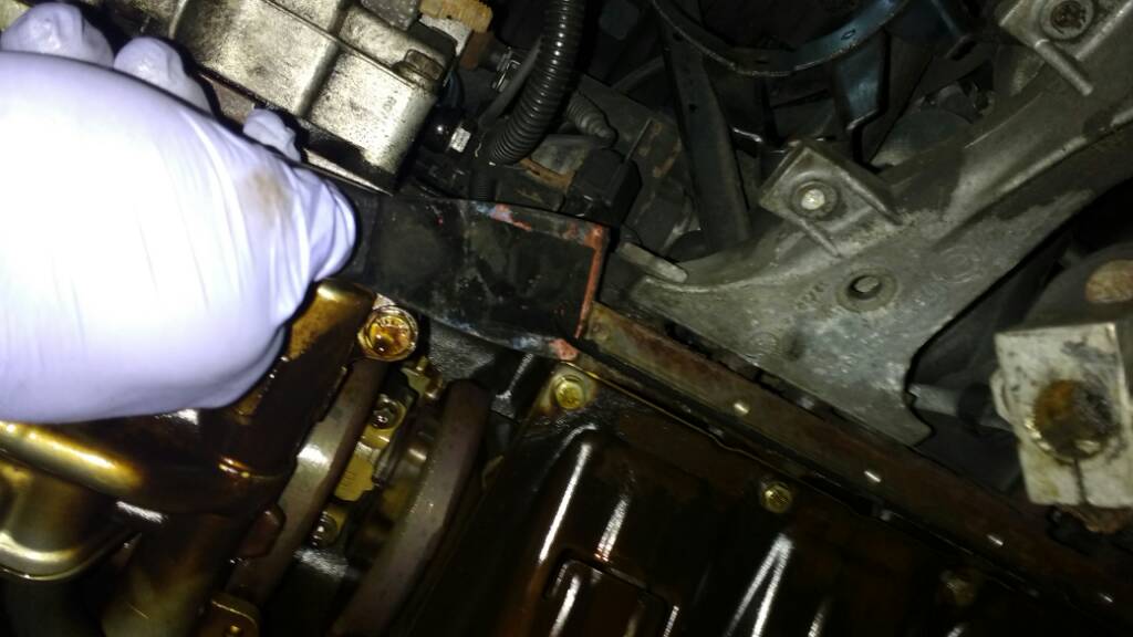

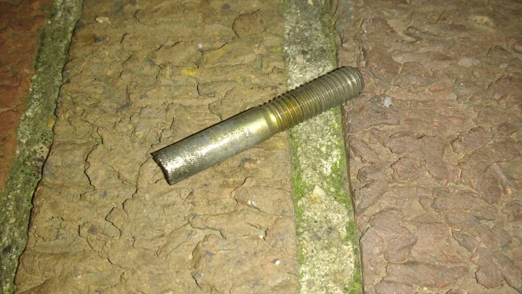

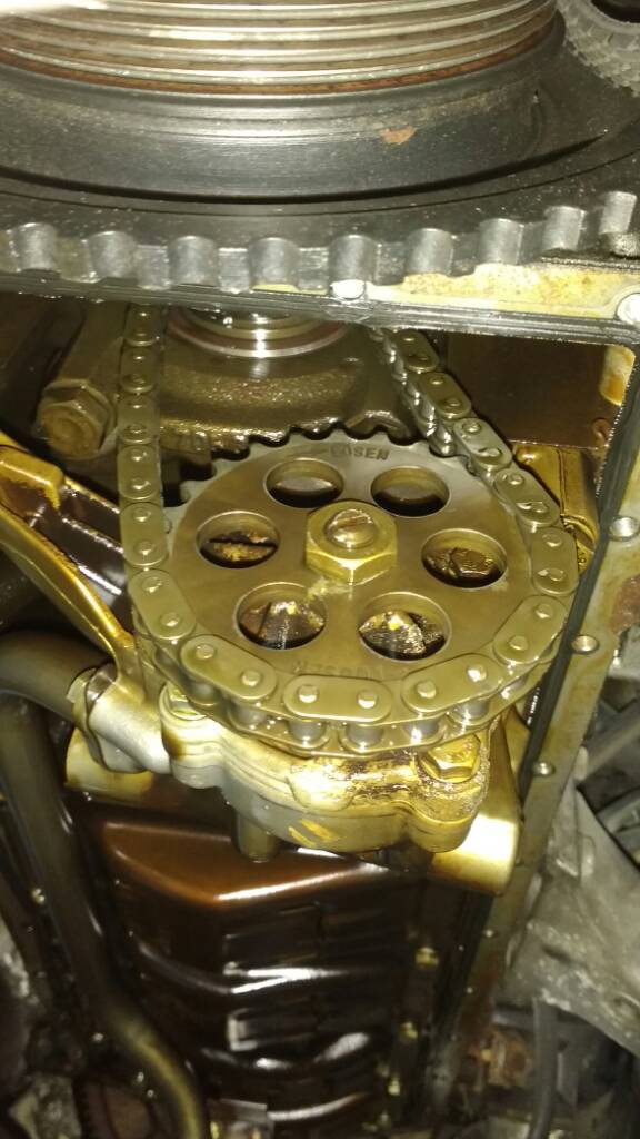

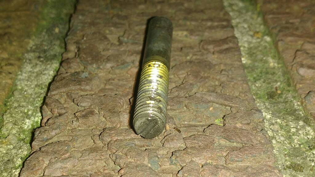

One of the bolts holding the pan from the transmission had the head rounded out. So I cut the head off with a dremel. I also cut a line on the other end of the bolt to unscrew it out. Lol.

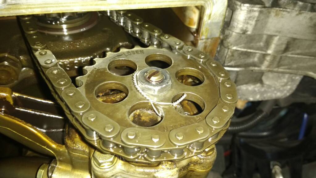

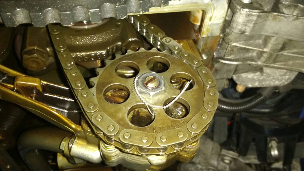

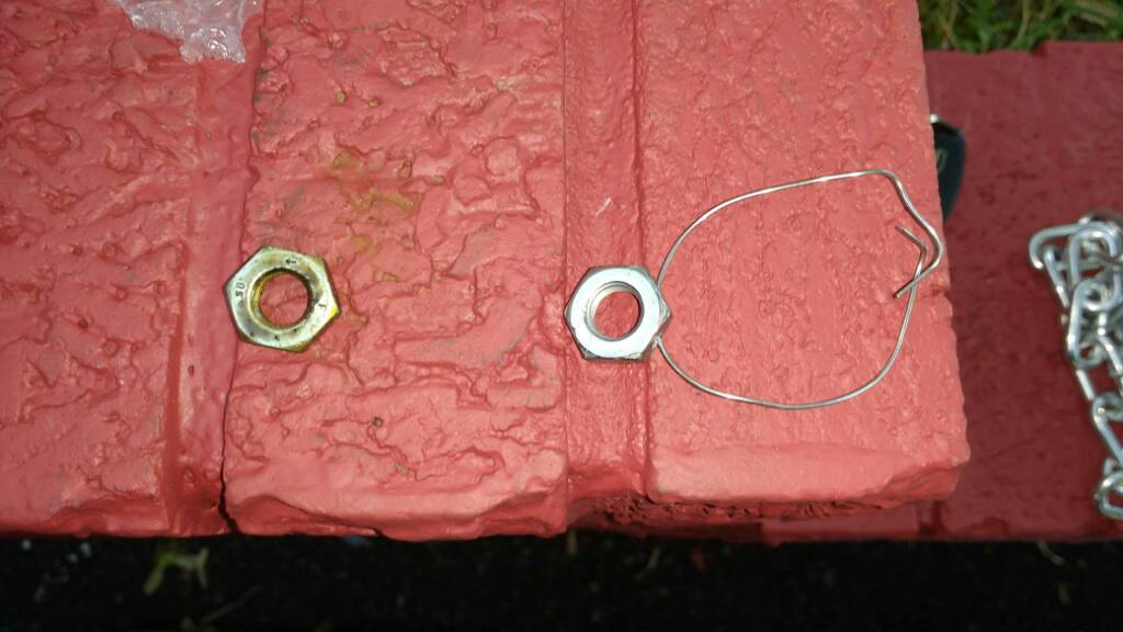

I replaced the oil pump nut with the modified one. It was my first time using a safety wire. I think it is wired well. Lol. I also put thread lock on the nut just to be safe.
I scraped off the excess old gasket material.
And the new gasket is installed.
I still need to install the steering rack and power steering pump.

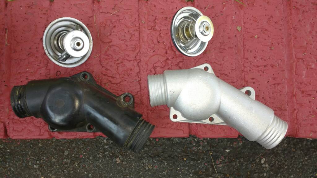

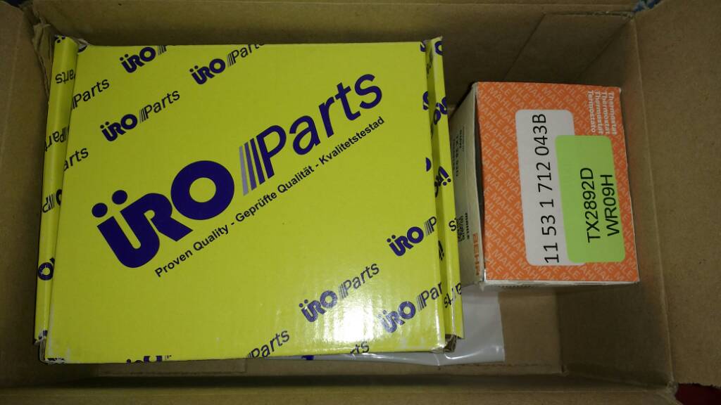

These just came in today. Thermostat, aluminum thermostat housing, and the can of POR15.
I didn't realize that I had to change the thermostat when I replaced the water pump. Thats probably the reason why the car was getting weird temp readings when I was driving it after the water pump change.

Even though at work we can get away with not changing a thermostat with a water pump R&R or coolant exchange, I always try to do it on my personal vehicles but I'm no saint to that I promise you lol
It was stupid of me. It's pretty easy to flush out the system at least. I won't flush all of it since the coolant is still fresh.

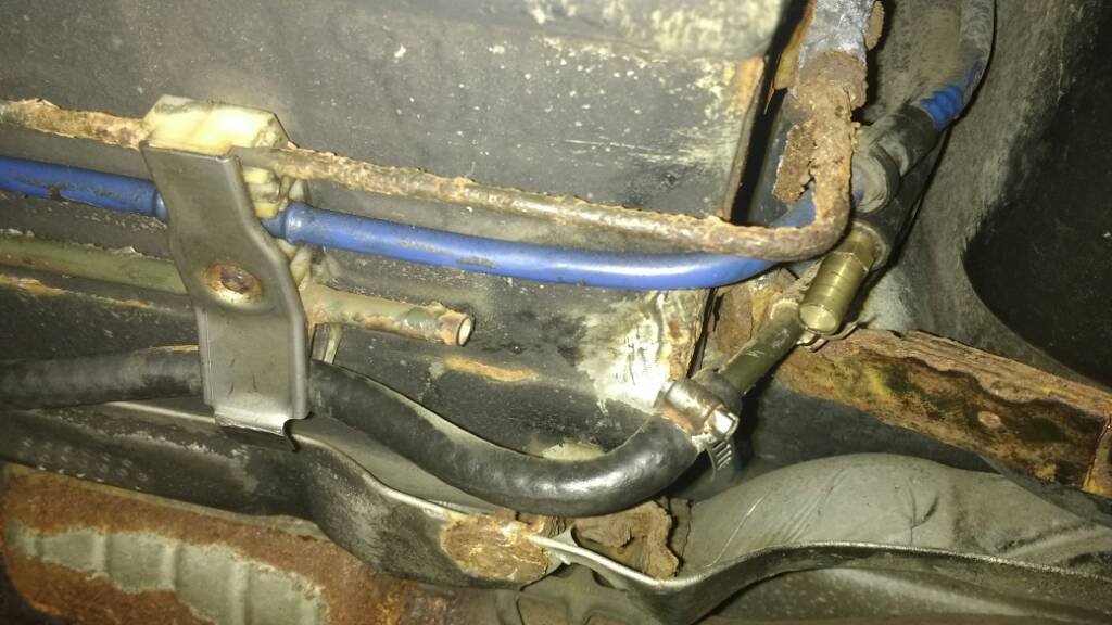

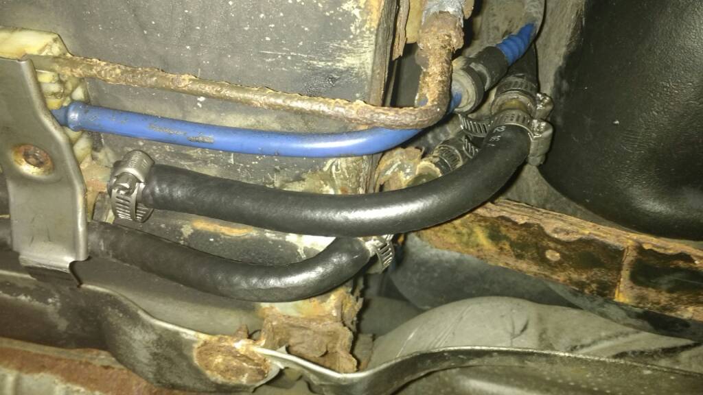

I fixed the fuel leak issue by cutting out the fuel pipe with the pin hole. I then added a fuel hose that connected to the end of the fuel hose using a double sided barb.

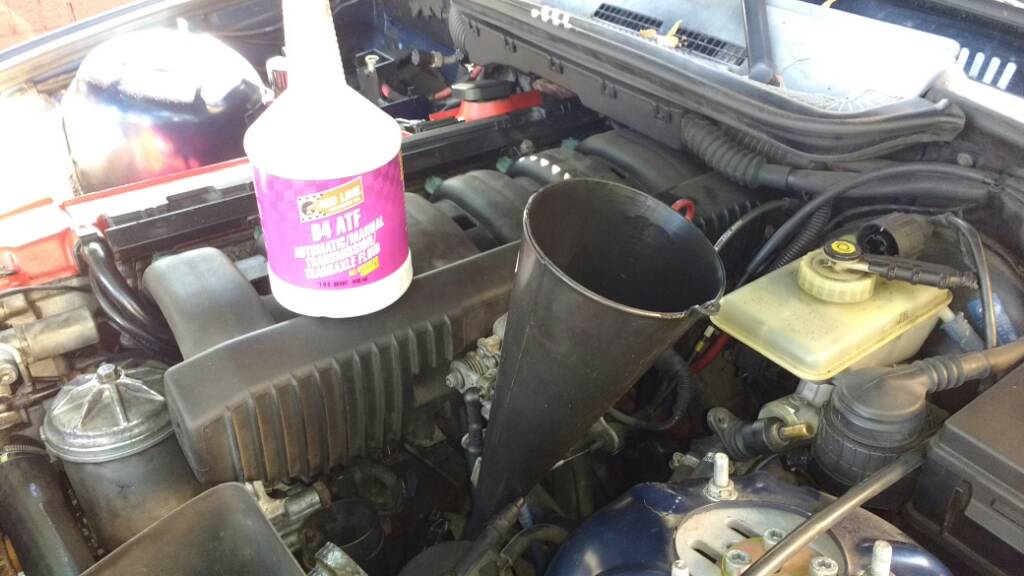

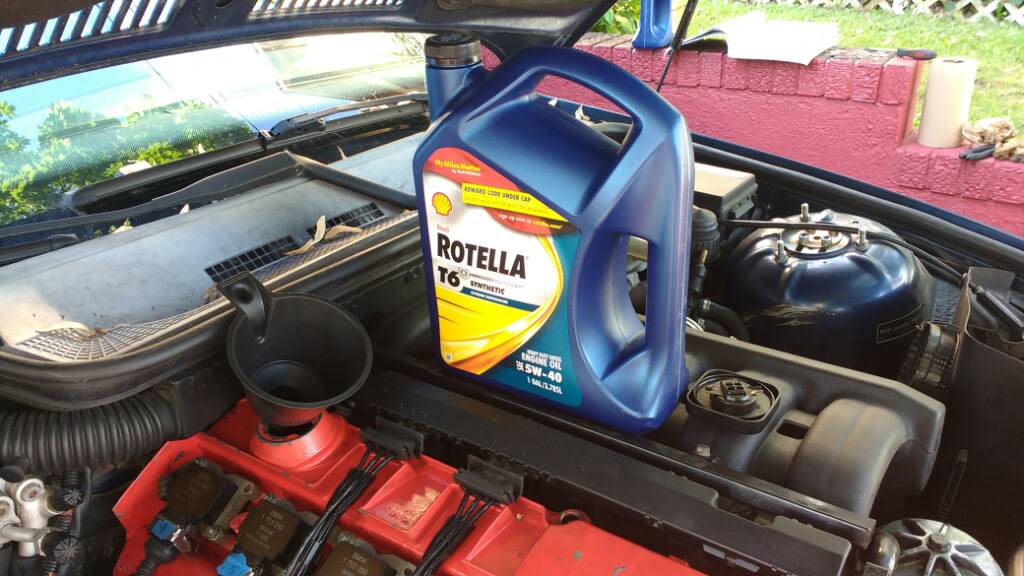

I filled the power steering reservoir with fresh Redline ATF.
I also added Rotella 5w-40.

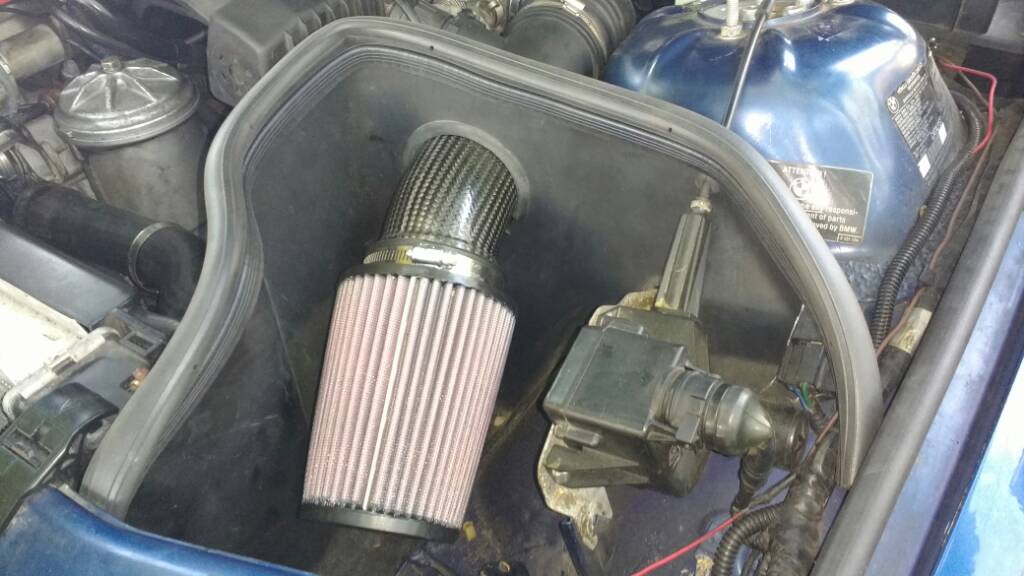

The heat shield did not have weather stripping so I put one.

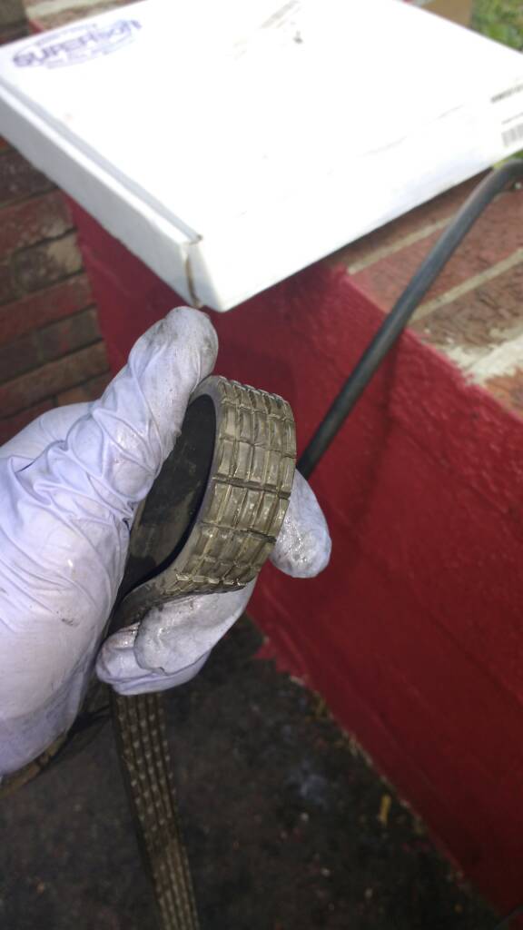

The belts were changed since the old ones were cracking.

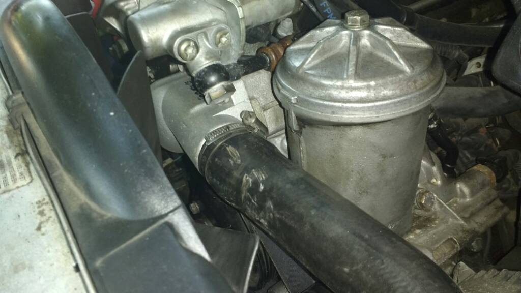

And the thermostat and thermostat housing were changed. I didn't have to flush out the cooling system and only removed the clutch fan to install the thermostat/thermostat housing. It was easier than I thought.
