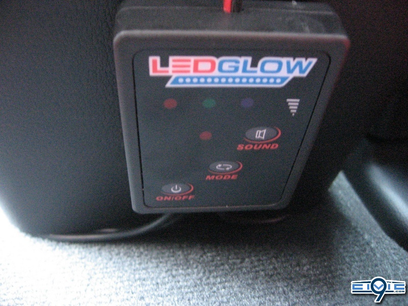

- 1.5" x 2.5" Controller (for color changing, sound, constant-on, pulse, etc etc..)

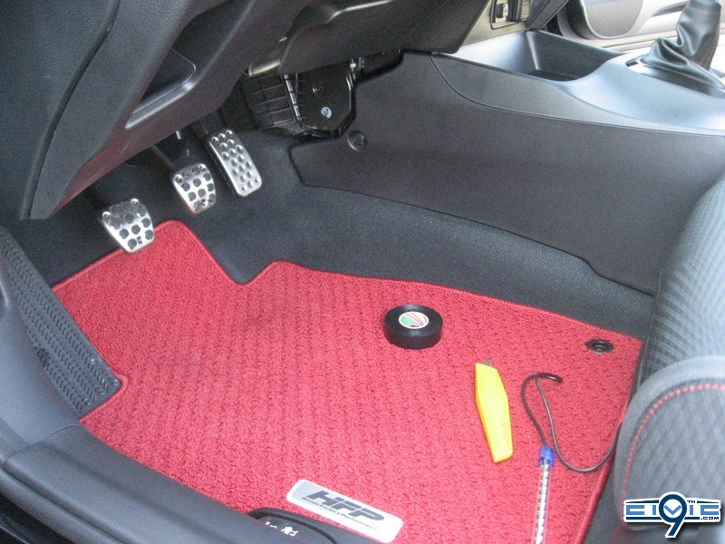

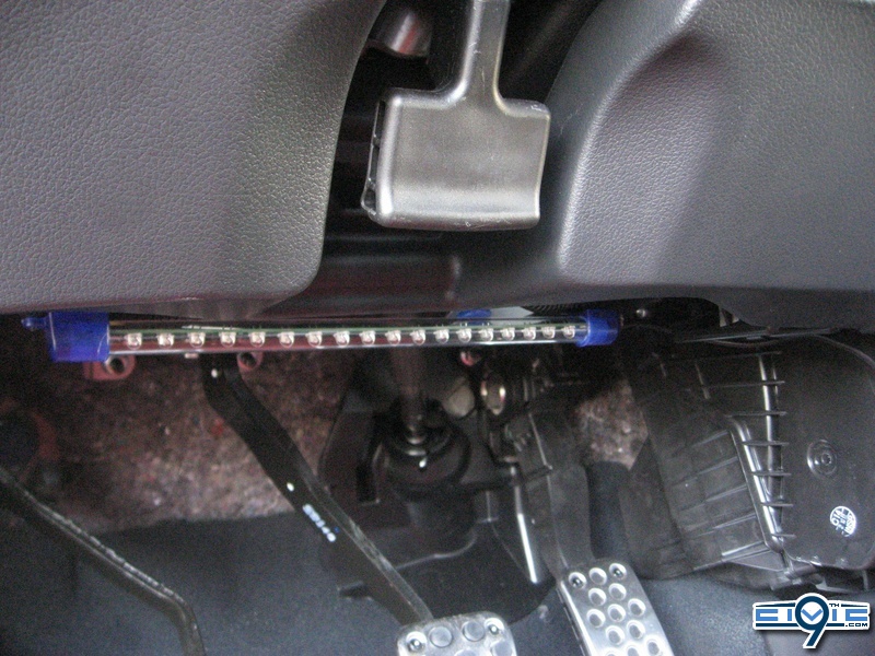

Here we are! About two hours for a full installation! Looks phenomenal!!!! Don't take my word for it tho, see for yourselves
I'm a big computer hardware guy, and cable management is utmost important to me! I took panels apart, slid wires, and drilled holes to make this mod PERFECT!!
For reference sake, the system is supposed to be soldered to a 10A circuit, i only used the 15A circuit in this case because it was easiest for me to take the two 24 gauge wires, solder them, then have them marette'd to the lighting systems wiring. LED glow used standed AWG #24 as you can see, so i just got AWG #24 stranded as well
As for grounding, you can use any bare metal in the call. I used the bolts used to fasten the seat belts in the rear seat because i ran 12v to the rear of the car for a plug and for my trunk lighting

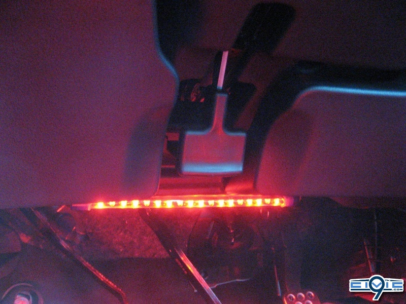

Tell me what you think! Keep in mind these pictures are taken in BROAD DAYLIGHT (PIC #9 you can really tell), so it'll look a lot better tonightt

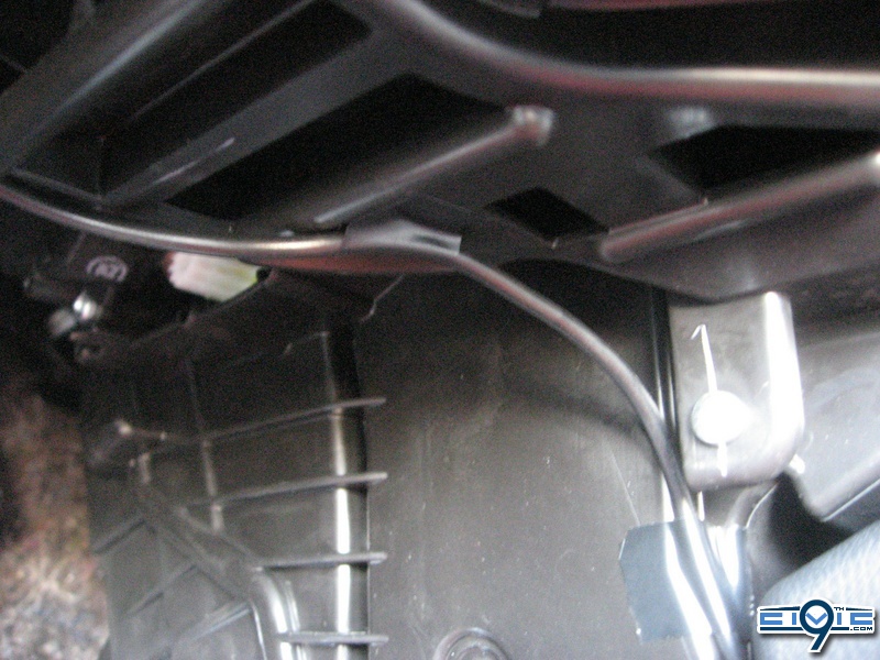

![pZles.sized.jpg](/forum/proxy.php?image=http%3A%2F%2F9thcivic.com%2Fgallery%2Falbums%2FInterior%2FpZles.sized.jpg&hash=aa719d11dedc40f6bfe6cdd6431e60e4)
Can't even tell there are wires there! Use of black electrical vinyl tape

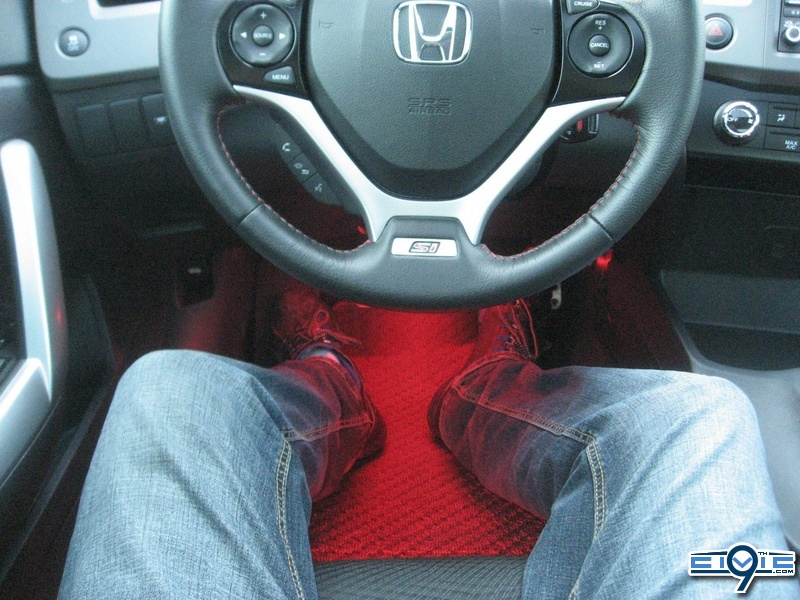

![PlTbS.sized.jpg](/forum/proxy.php?image=http%3A%2F%2F9thcivic.com%2Fgallery%2Falbums%2FInterior%2FPlTbS.sized.jpg&hash=0a9913b78f9229dcc2259e25c8331f50)
![eH3K3.sized.jpg](/forum/proxy.php?image=http%3A%2F%2F9thcivic.com%2Fgallery%2Falbums%2FInterior%2FeH3K3.sized.jpg&hash=c082adf8b3e36cc58fbca94abb86cb84)
Not a Wire in sight! Serious cable management skillz! :p

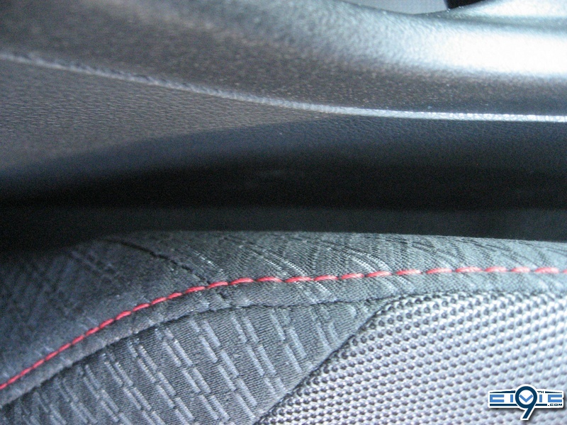

![tQQSR.sized.jpg](/forum/proxy.php?image=http%3A%2F%2F9thcivic.com%2Fgallery%2Falbums%2FInterior%2FtQQSR.sized.jpg&hash=2edc40ac4571939df6d2ce839bc72492)
![yCDpY.sized.jpg](/forum/proxy.php?image=http%3A%2F%2F9thcivic.com%2Fgallery%2Falbums%2FInterior%2FyCDpY.sized.jpg&hash=36c8252176d23c63ee8912231e63b0ba)
![G6E64.sized.jpg](/forum/proxy.php?image=http%3A%2F%2F9thcivic.com%2Fgallery%2Falbums%2FInterior%2FG6E64.sized.jpg&hash=e2ac9ba4f74a73fe79972b45602c2264)

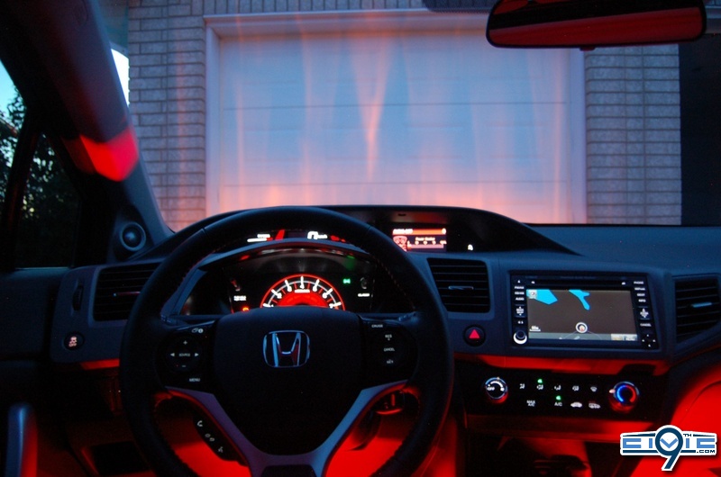

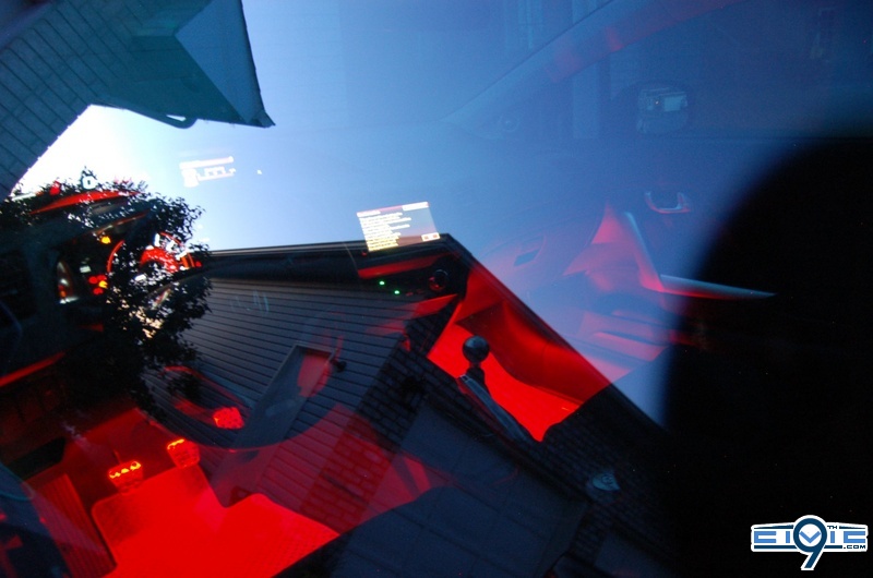

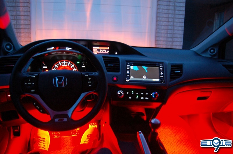

Night Shots!!
What you'd see on from a shiney windows :p
![mZzid.sized.jpg](/forum/proxy.php?image=http%3A%2F%2F9thcivic.com%2Fgallery%2Falbums%2FInterior%2FmZzid.sized.jpg&hash=5b33ad4ee150844d6c79e0ffb5b6597d)
Litterally took me like a hundred tries for this... but this is a passenger wide angle shot
![Smile :) :)](/forum/styles/default/xenforo/smilies/smile.png)
![bzS8K.sized.jpg](/forum/proxy.php?image=http%3A%2F%2F9thcivic.com%2Fgallery%2Falbums%2FInterior%2FbzS8K.sized.jpg&hash=237442f8fafd06cc1c7c7ddc7cdb72a1)
Drivers view..
![CccCS.sized.jpg](/forum/proxy.php?image=http%3A%2F%2F9thcivic.com%2Fgallery%2Falbums%2FInterior%2FCccCS.sized.jpg&hash=e6417dc722cf41b305741573d4f1f7f8)

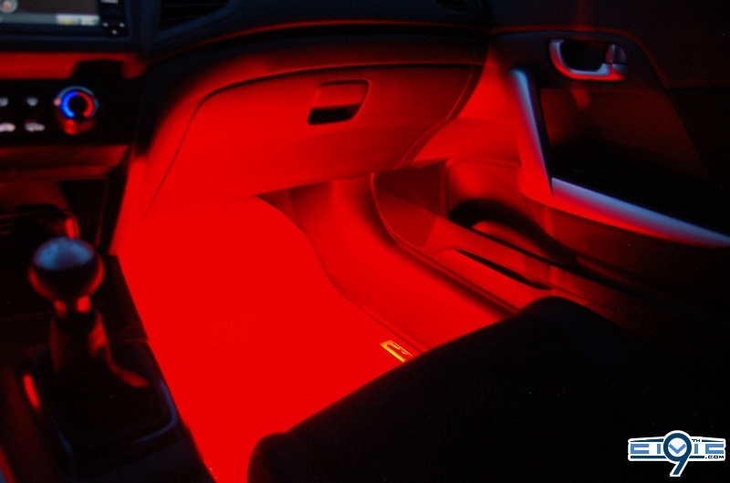

So much light its hard for the camera to focus... This is the passenger side flooring
![x1eKG.sized.jpg](/forum/proxy.php?image=http%3A%2F%2F9thcivic.com%2Fgallery%2Falbums%2FInterior%2Fx1eKG.sized.jpg&hash=e85e050a1409369e11d1e96220678a18)

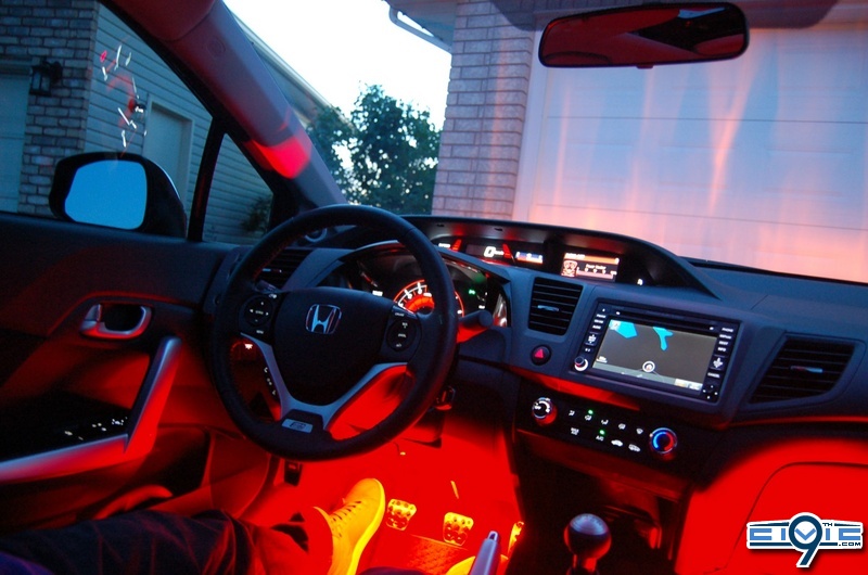

This is the widest angle this lens can achieve but it gives you a good idea of the light spread throughout the cabin in near completely dark lighting...
![YfLrY.sized.jpg](/forum/proxy.php?image=http%3A%2F%2F9thcivic.com%2Fgallery%2Falbums%2FInterior%2FYfLrY.sized.jpg&hash=8f54cb604a8f1009af75abe5d27fa863)
Any Questions?? Feel free to ask
